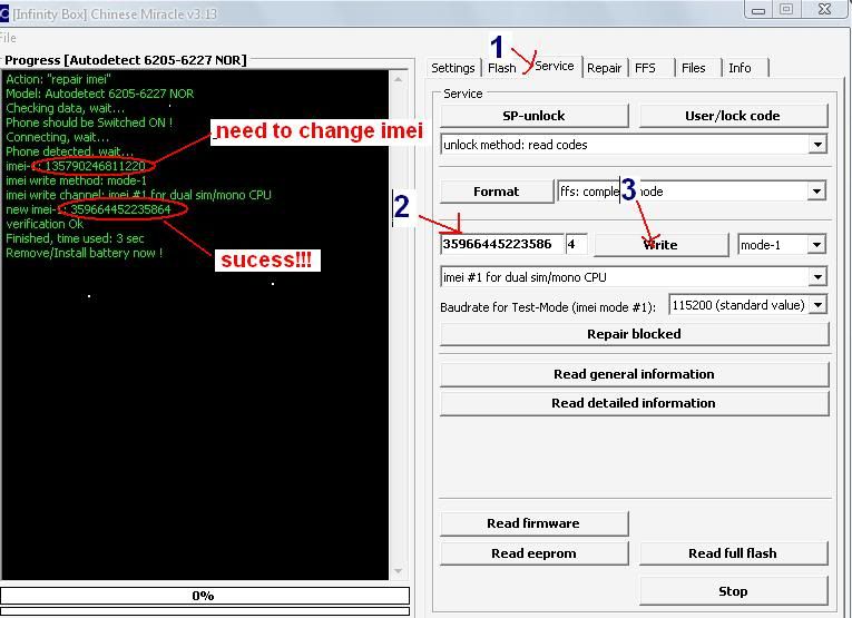

*change imei for no service problem

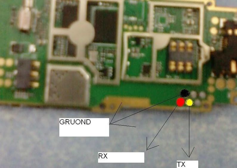

PROCEDURE:
PINOUT FIRST

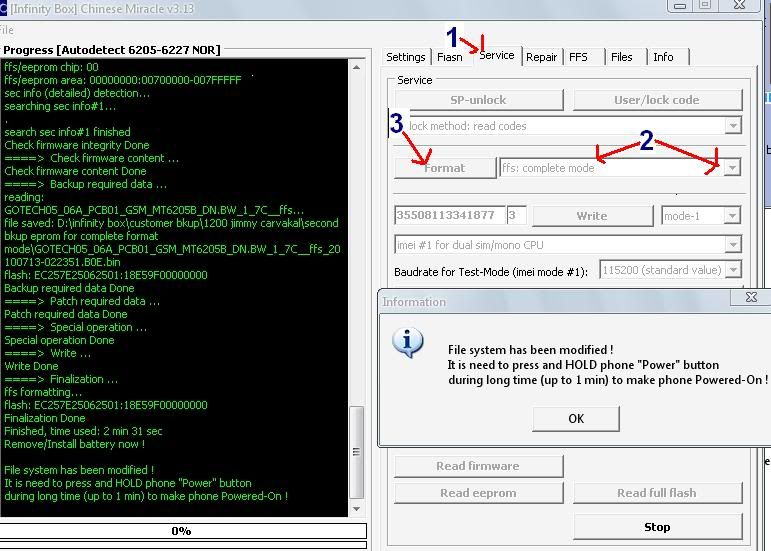

SERVICE > COMPLETE MODE > FORMAT >

ffs formatting...
flash: EC257E25062501:18E59F00000000
Finalization Done
Finished, time used: 2 min 31 sec
Remove/Install battery now !
File system has been modified !
It is need to press and HOLD phone "Power" button
during long time (up to 1 min) to make phone Powered-On !
After format No service ang phone , changed IMEI lang.

ffs formatting...
Finalization Done
