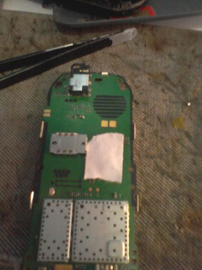

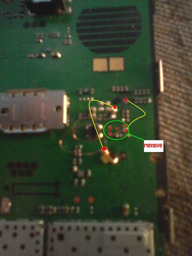

A AltF4 Registered Joined Sep 3, 2014 Messages 1,285 Reaction score 7 Points 181 Oct 23, 2014 #1 1280 no light done sa dalawang jumper 1280 no light done sa dalawang jumper fallow this sulotion...
er2x_1989 Registered Joined Jun 17, 2014 Messages 70 Reaction score 0 Points 1 Oct 23, 2014 #2 boss kahit ba putol yung line ng light (+,-) magkaroon po pa kaya ng light kung ito gagawin ko buguhan lang po BTW congratss..........................
bojs Registered Joined Jun 12, 2014 Messages 2,415 Reaction score 31 Points 381 Oct 23, 2014 #3 mahalaga talaga yung tape kasabay ng tiyaga. congratz boss. br, bojs
