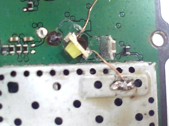

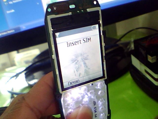

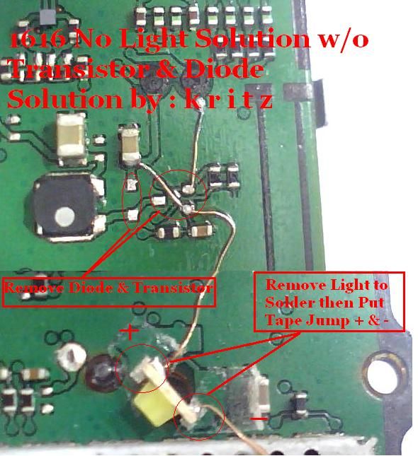

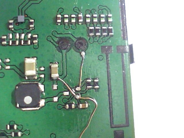

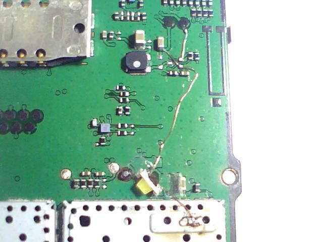

Problem :
No Lcd Light & Keypad
Cause :
Diode or Transistor Fault -- > No Parts to Replace
Solution :
Remove Diode & Transistor Then ByPass TESTED 100% Since 2011 :))
Screenshot & Solution How to
