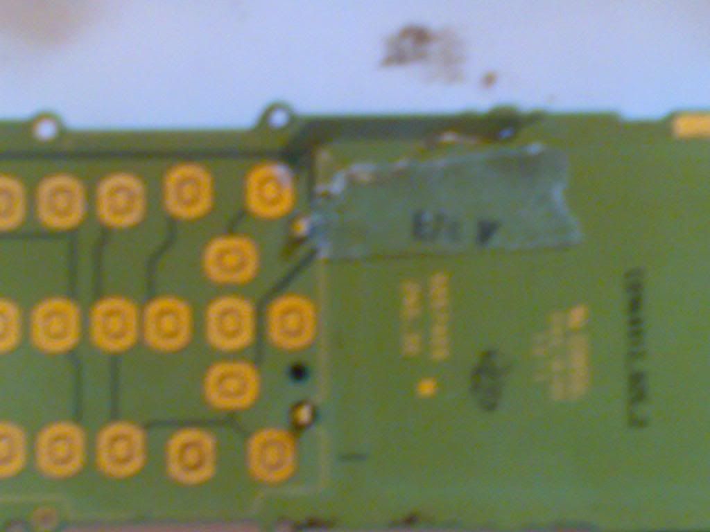

1680-2 key 147* Malfunction Done
Model: 1680-2
Problem: Key 147* Malfuction
Action Taken---> Bakalas ko ang Unit Change Keypad I.C.--->no luck
kaya Tinignan ko Front pcb Board, Kaya pala kinain ng kalawag
---> linis Mode, nakita kung may isang Connection na putol kaya
ito ginawa ko.

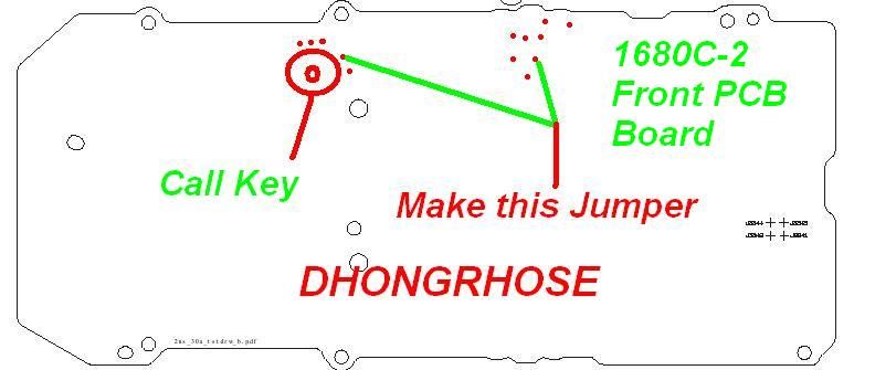

Malabo kc masyadong Pino ang Connection na putol, kaya gumawa ako ng Pcb Diagram ---> watch
Hayan Klaro na..
Finish Product:
