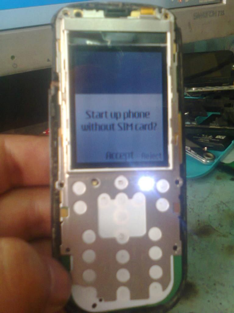

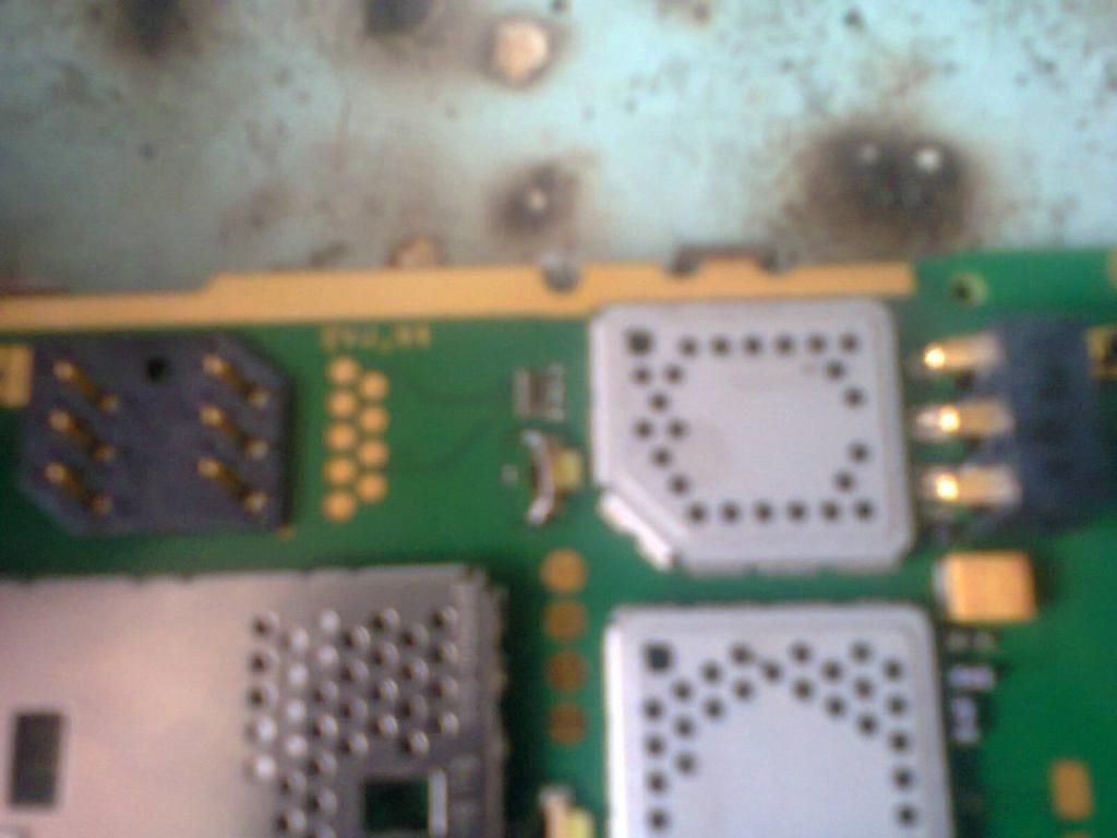

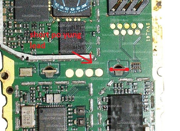

S soLVer_tech Registered Joined Oct 17, 2014 Messages 2,447 Reaction score 22 Points 381 Jan 28, 2015 #1 2330c no light done dagdag ko lang po with simple way no light po change lcd ,no lock tester led, ok naman, short ko yung led sa kaliwa, done, tested ko na to sa mga 1200,1208.
