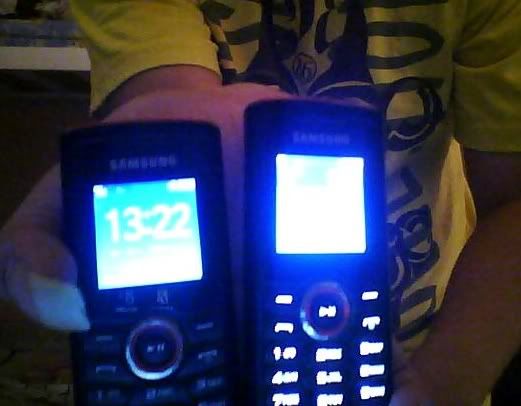

e2120 blinking done
unit:E2120
phone status:blinking

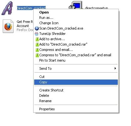

1st procedure:

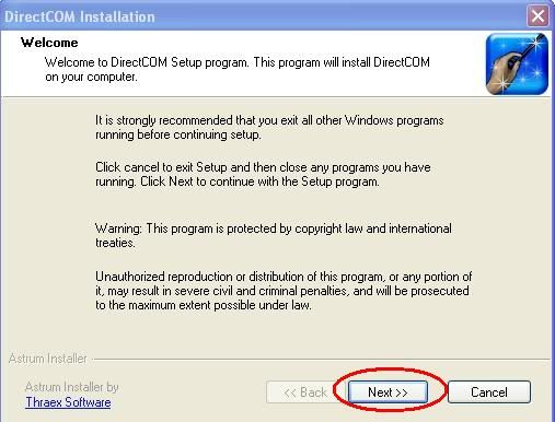

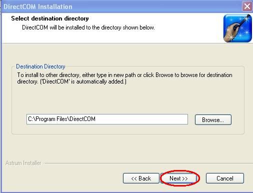

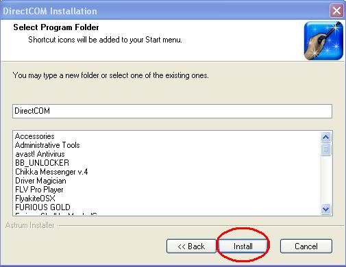

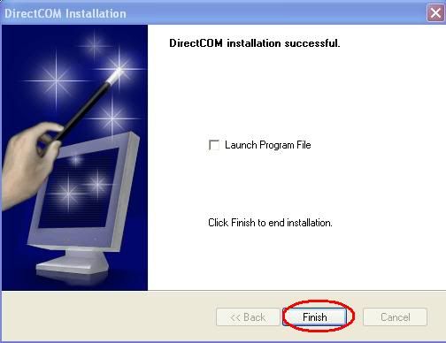

download directcom
then install

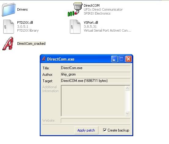

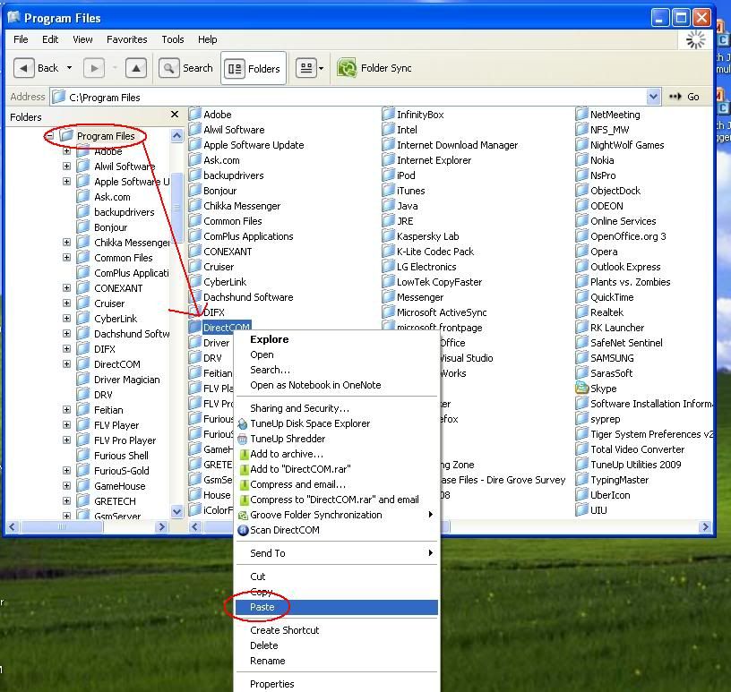

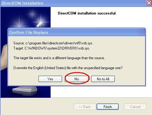

tapos punta po tayo sa directcom folder copy poh ung directcom crack
sa C:\Program Files\DirectCOM

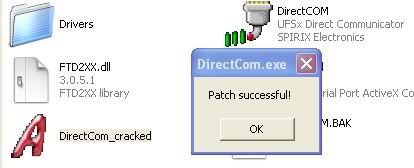

then run directcom crack click apply patch

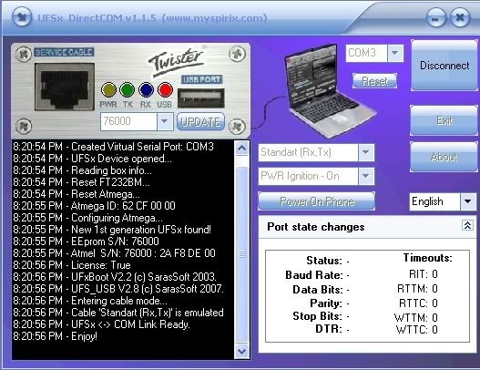

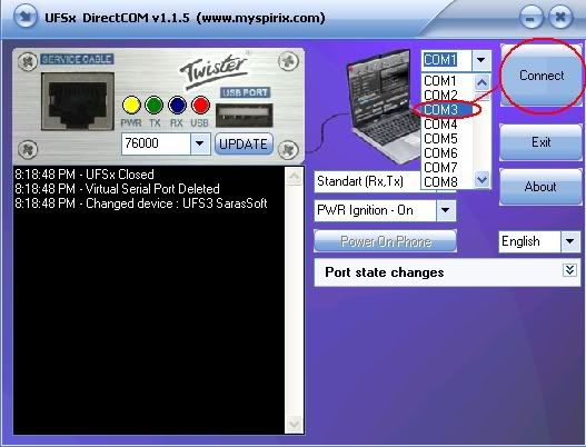

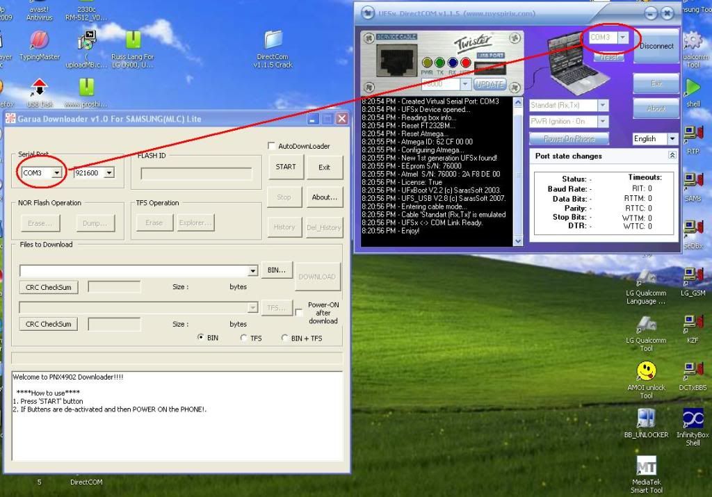

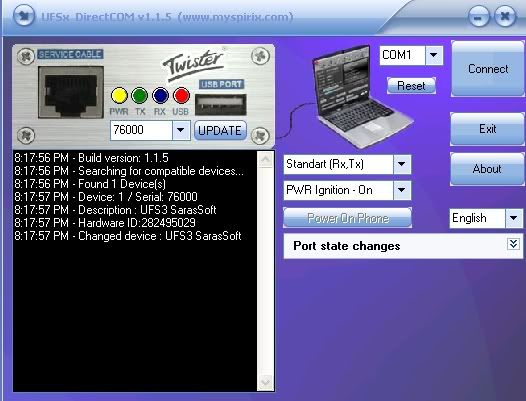

run directcom select com then press connect
connect logs
so ready na poh ung directcom..

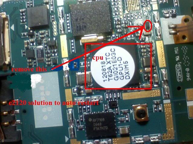

bago mo software bukas mo muna ung unit
at tanggalin mo to bago mo program

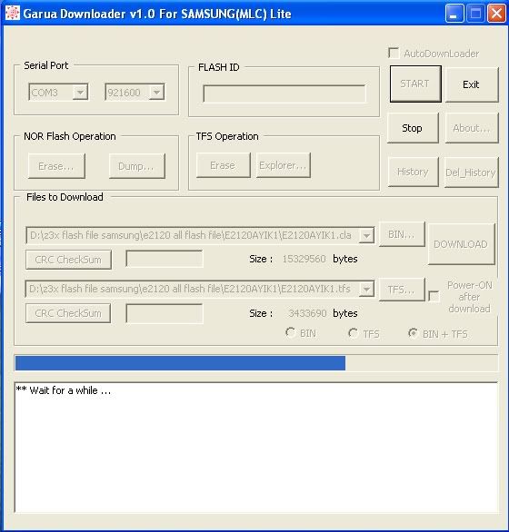

3rd procedure:

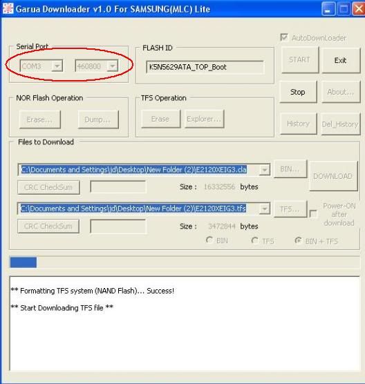

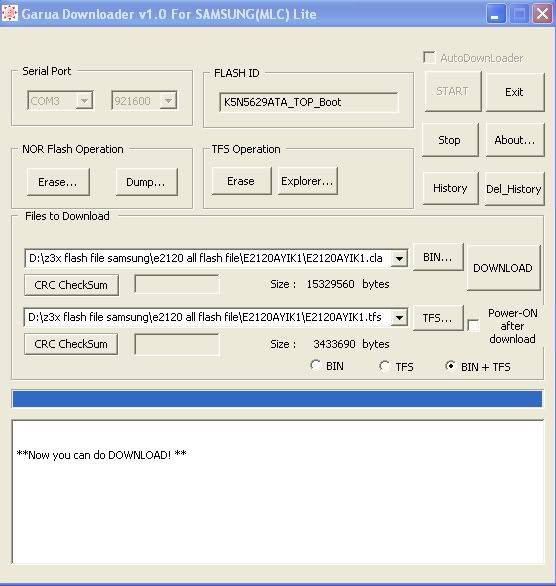

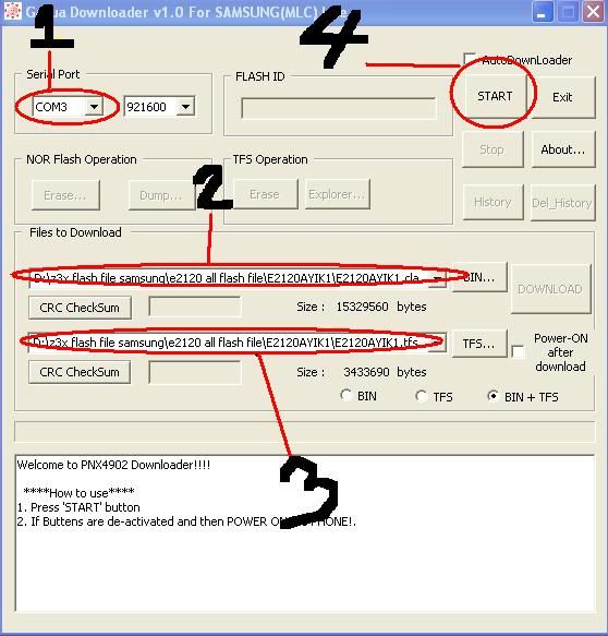

open free software
select com like this
load tested firmware then press start
logs
click download
logs
tapos ibalik ung tinanggal bago mo pinogram
finish:
note: tested ko na poh tong procedure na to
hanggang now wala pa bumabalik

1st procedure:
download directcom
then install
connect logs
