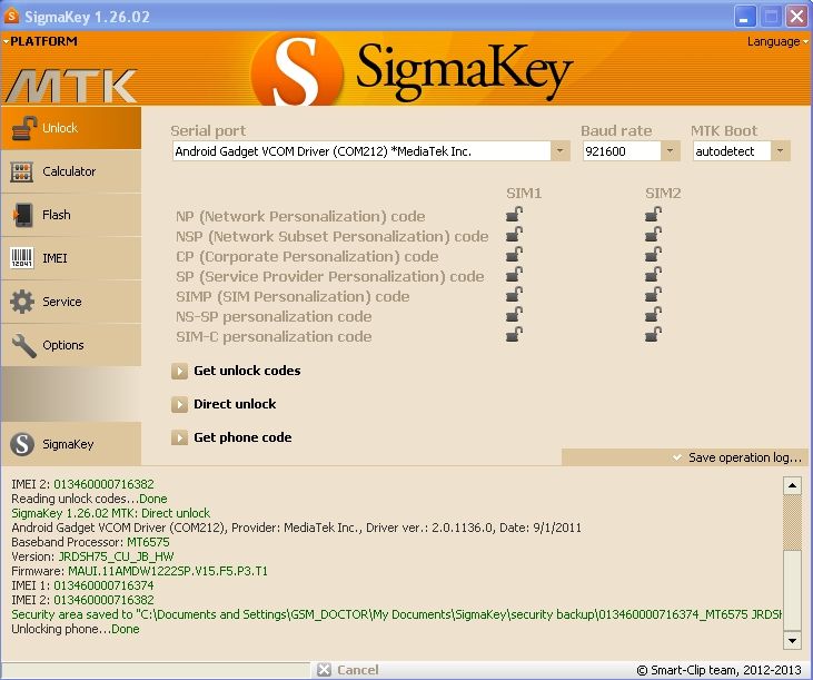

4030e one touch unlock done.[Reference]
AltF4
Sep 3, 2014
1,285
7
181
salamat naman at support na rin ng bagong update nang sigma key ung one touch 4030e
PROCEDURE---power off the phone then fullout the battery
---reinsert the battery after 10 secs n connect micro usb cable to pc ( don't power on the phone) just insert micro usb only
---install drivers if needed
---now open exe, choose platform mtk n select proper serial port
---finally press direct unlock
