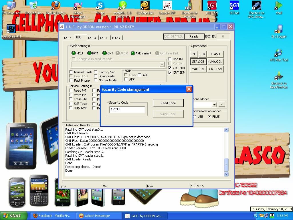

Problem:
pag unlock security code na limotan ng my kanya.
Tools:
*JAF box W/th P-key
*Cable RJ45 5130
Action Taken:
1. open Launch JAF
2. click BB5
3. operation click CHECK
4. services settings click USER CODE EDIT, and Click Services

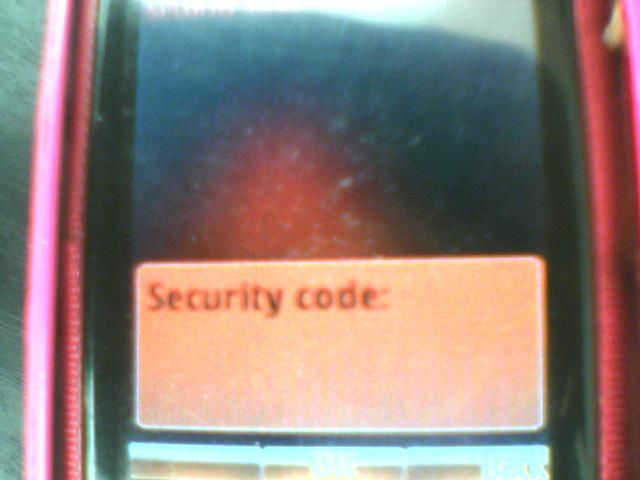

5. open ang unit Inter ang code na binasa ng Jaf

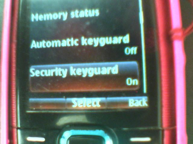

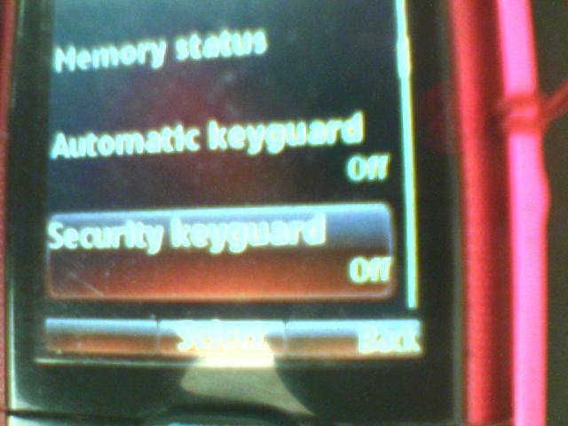

6. Go to Settings/Phone/Security Keyguard para ma off
done.
