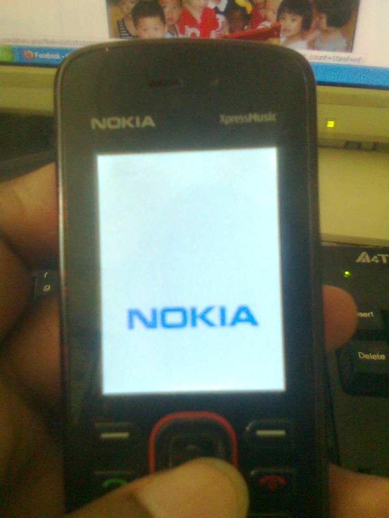

5220 nokia only done via mxkey usb flashing...
share lang po ako mga boss..
logs..

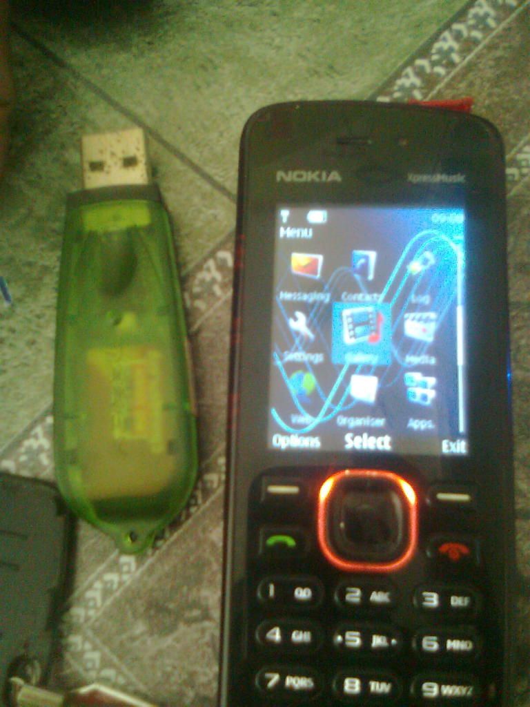

Total time for flashing process(boot+erase+write) was 9 min 26.125 s
Waiting for USB device removal ...
Waiting for device boot up ...
Device connected: nmwcdc\Nokia 5220 XpressMusic USB Phonet, PORT_ID: 35DB8A7F
Verifying communication to device OK.
Phone type: RM-411 (Nokia 5220 XpressMusic)
SW version: V 07.23 17-07-09 RM-411 (c) Nokia

finish product:
tnx 4 viewing mga bro...godbless all!!
thanks to:dark
