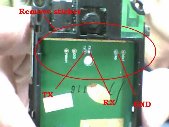

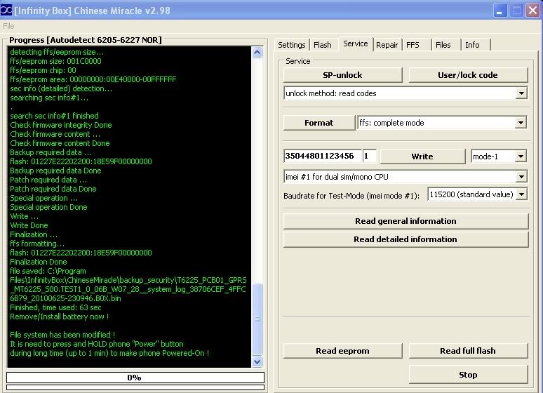

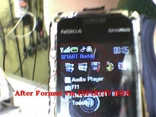

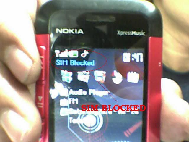

B BLIND Registered Joined Dec 23, 2014 Messages 2,965 Feb 25, 2015 #1 ** 5310 Sim Blocked Problem Done ** Procedure : Open Infinity Shell Select Chinese Nokia Select Unit Tick Run 5310 Search Pinouts Resolder Rx , Tx , GND Infinty Software Select ffs : Complete Mode Tick Format Wait Until DOne Change Imie Done !!! Screen Shot :
