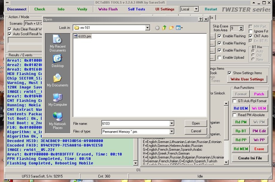

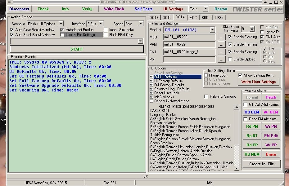

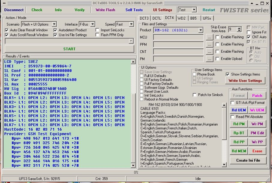

STEP 1-----read info w/ my tools HWK V2.2.0.3
WRITE FLASH KO SA 6103
http://i1301.photobucket.com/albums/ag119
/cyvertech90/6102iflash6103_zpsbde1cd2c.jpg

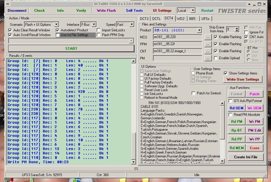

WRITE GOOD PM
UNLOCKING......

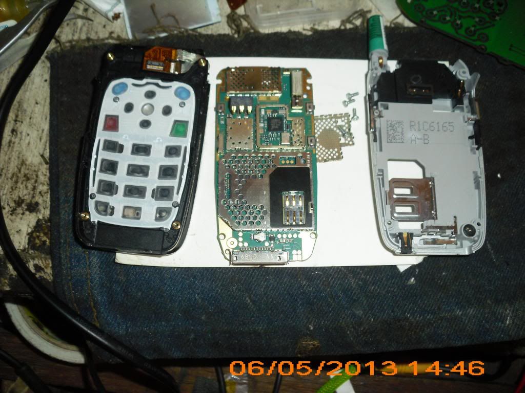

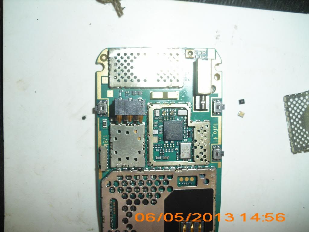

STEP 2----- BAKLAS UNIT
CONVERTING TIME..

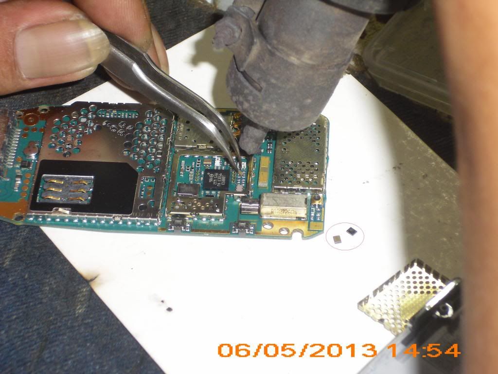

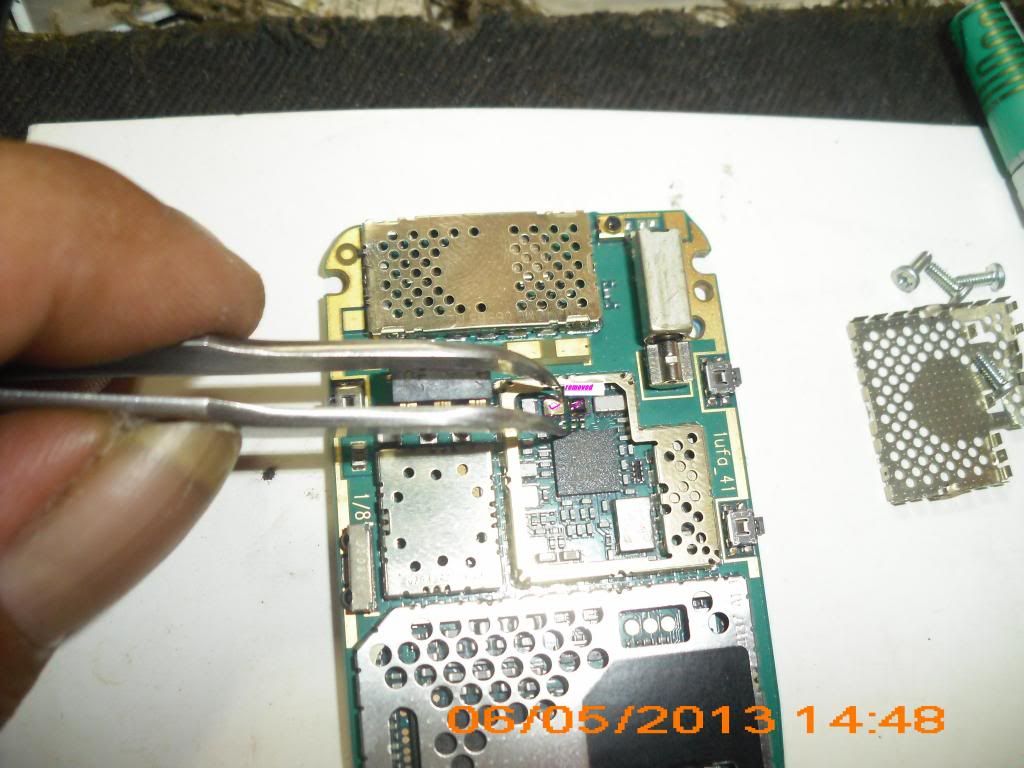

REMOVED TWIN FELTER IC
PUT RESSESTOR
TESTING TIME

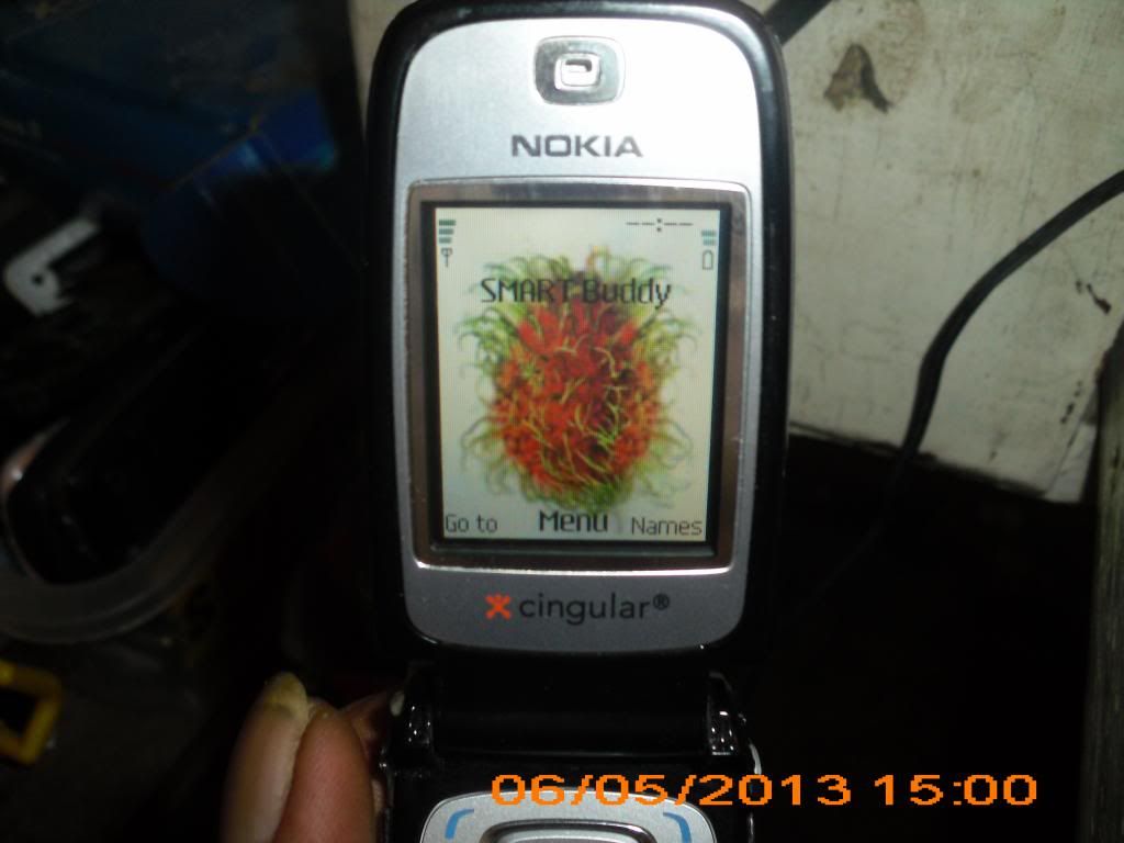

YAN MY SIGNALna DONE
ITO PO UNG GOOD PM
