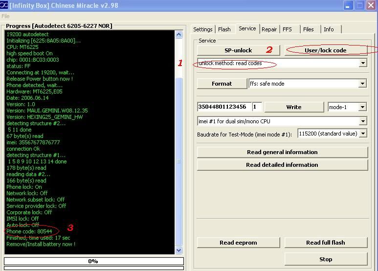

Problem :
Lock Code
Action & Procedure :
Use Infinity Box
Resolder Rx , Tx , GND
Open Infinity Software
Select Chinese Nokia
Select Unit
Tick User/lock code
Power on
wait until done
Enter Code to Phone
Done
Screenshot :
