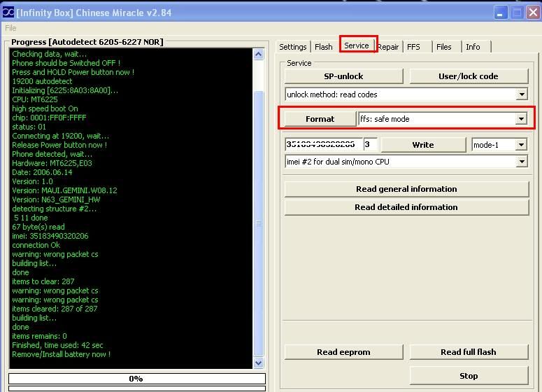

Problem :
can't send message (imei #2 --137272)
Action :
try to rebuild imie no luck
try to use mode 2 , 3 no luck
try to re-format Done no need to rebuild imei , imei automatic repaired !!!
Logs :
