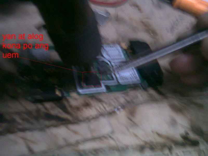

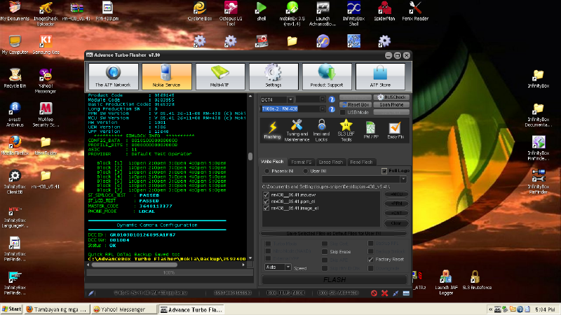

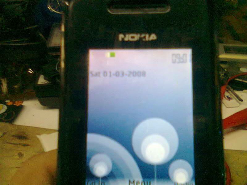

FRANGIE-21 Registered Joined Oct 24, 2014 Messages 52 Reaction score 1 Points 1 Location san pedro laguna landayan Oct 24, 2014 #1 SHARE KO LANG PO MGA BOSS NO SIGNAL HISTORY BIGLA NLNG DAW PO NAWALA ANG SIGNAL NIYA ACTION TAKEN TRY KO PO MUNA FLASH SA ATF THEN WRITE PM OK NAMAN KASO ALA PADIN SIGNAL MGA BOSS TRY KO PALIT NG 2N2 KASO GANUN PADIN TRY KO PO SA UEM ALOG ITO YUN DALI MAY SIGNAL NA PO MGA BOSS DONE 300 LANG PO
