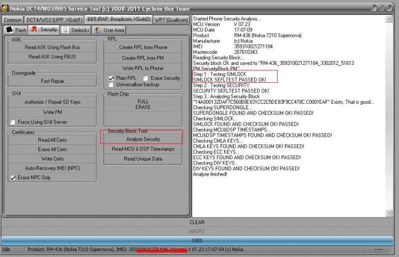

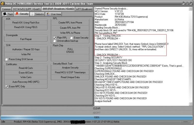

2.Go to Security Tab then Analyze Security (Para makita anong Cause ng Contact Service)

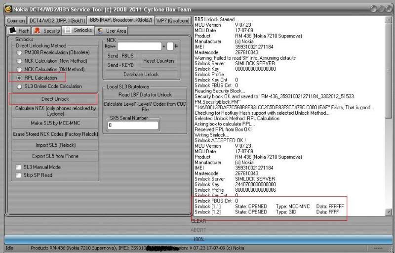

3.Go to Simlock Tab Tick RPL Calculation then do Direct Unlock
Done

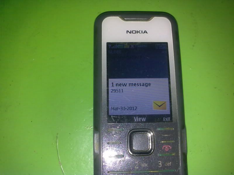

Before
After
Finish Product
