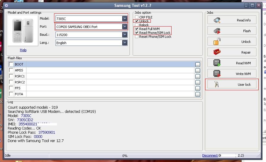

730sc phone lock done!
unit : samsung softbank 730sc
problem : phone lock / security code
tools
z3x box
730sc cable
procedure
1.connect box open samsung tool 12.7
2. select right model
3. connect power on phone in usb connection ( install driver if needed)
4. select right com port
5. check unlock/read full nvm/read phone/ simlock
6. thick user lock
DONE
for referrence only!
tools
z3x box
730sc cable
procedure
6. thick user lock
DONE
