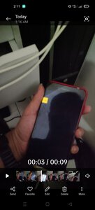

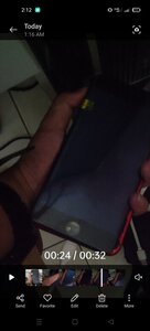

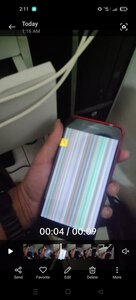

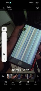

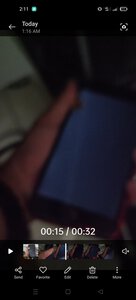

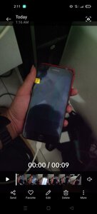

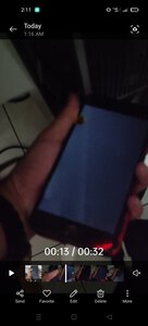

Unit: 8plus
Problem: Pagkatapos mag palit ng housing bigla nalang no image or light only, tapos nag kukurap kurap na lines
check pic baka may naka encounter na sainyo wala ko idea dito first time encounter

boss try mo muna linis lcd terminals tapos try mo rin ng lcd baka my tama ang flex lastly boss try mo resolder ang lcd controller ic. salamat
