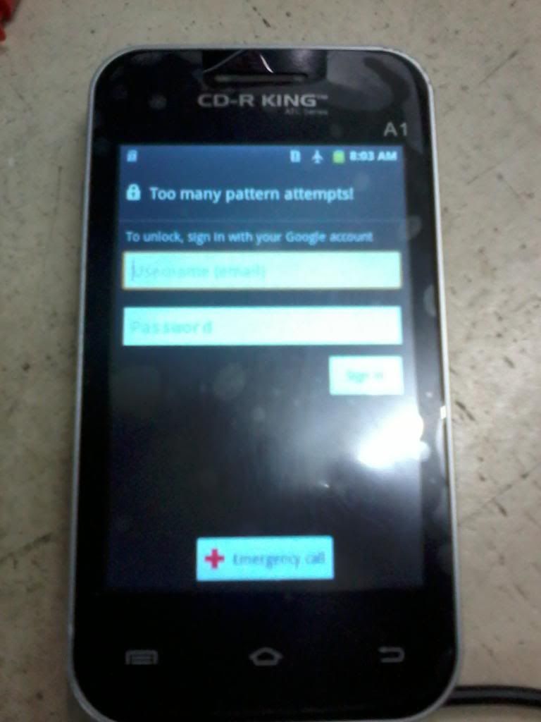

A1 CDR KING android T.M.P.A | Too many pattern attempts solution
A1 CDR KING android
Problem:
T.M.P.A

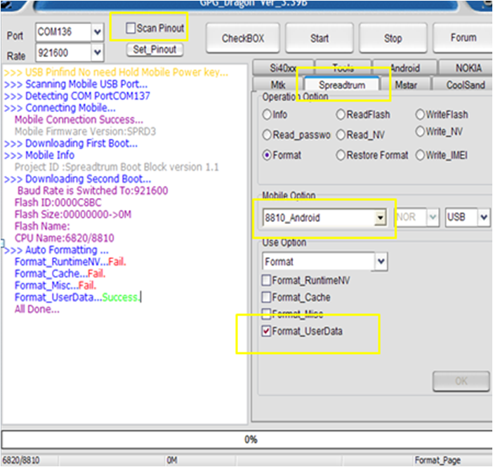

Solution:
1. open gpg dragon
2. tick spreadtrum
3. untick scan pinout
4. select mobile option 8810 Android
5. check format user data
6. tick start
7. done
SCREENSHOTS
done
