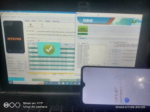

para sa wlang unlocktool :)
first link files scatter password gsmserverpro.com
(https://drive.google.com/file/d/1vkeGGu2_9JALZHoC9vK5hDXYXNs56wEc/view)

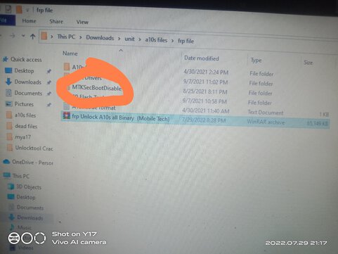

frp Unlock A10s all Binary (Mobile Tech) (mediafire.com)
step:
authentication bypass nyo mona. nasa pangalawa link yong tool para mag flash sa sp flash tool
click crash PL off the unit boot'up volume up insert usb..
pag natapos nyo na ma flash ng scatter files auto download nayan pag on ng unit flash nyo na 4 files sa odin.. hanap nlng kayo tested 4 files
my kasama nadin nya frp via sp flashtool format procedure :) IMG_20220729_211813[1].jpg
step:

gagana kaya to boss sa na dead sa flashing salamat sa sagot
gagana pag nag detec pa sa mtk usb... salpak mo usb open mo device manager kung nag dedetec ba... kung my detec mabubuhay yan
