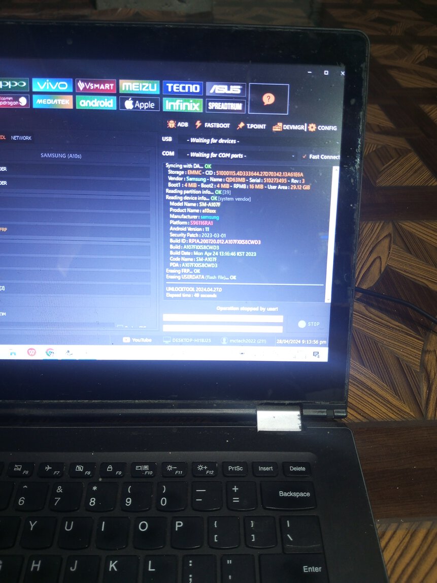

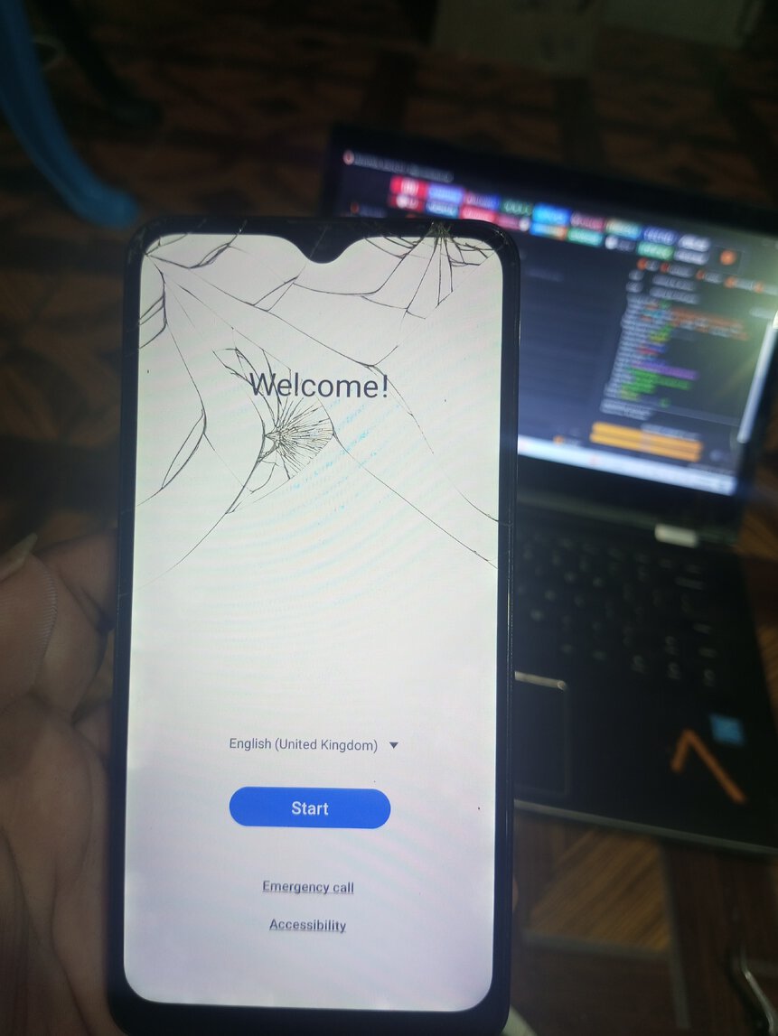

Try this method!
1.Open UnlockTool
2.click Samsung
✓search and click a10s(sm-A107F)
✓Click Brom|EDL
✓Click [Brom]Factory Reset+Frp
3.Press and Hold volume up and down
4.Insert the cable.
Done!
