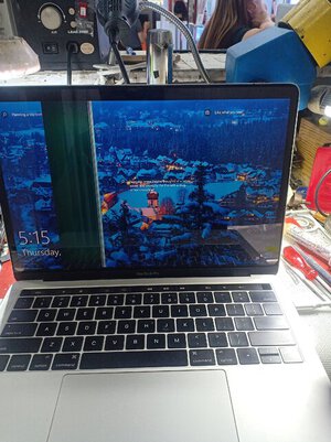

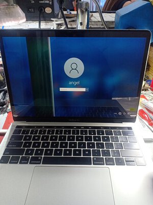

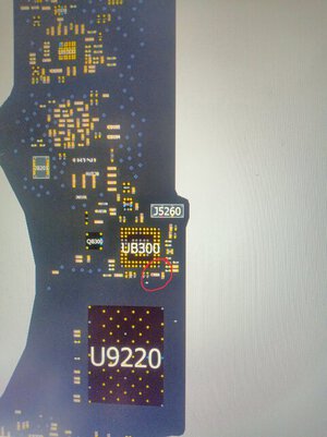

T totoedzkie80 Registered Joined Oct 30, 2022 Messages 12 Reaction score 11 Points 1 Location Manila Nov 5, 2022 #1 A1706 No Power CB300 short on PP3V3 _G3H ,, remove Caps solved Attachments IMG_20221105_194900.jpg 52.4 KB · Views: 49 IMG20220629171147.jpg 78.9 KB · Views: 49 IMG20220629171150.jpg 58 KB · Views: 49 Last edited: Nov 8, 2022
badmosfet Registered Joined Oct 30, 2022 Messages 28 Reaction score 13 Points 1 Location San Pedro Laguna Nov 8, 2022 #2 totoedzkie80 said: A1706 No Power CB300 short on PP3V3 _G3H Click to expand... master paano po ginawa ninyo remove po ba or nag replace na po kyo ng shorted parts po
T totoedzkie80 Registered Joined Oct 30, 2022 Messages 12 Reaction score 11 Points 1 Location Manila Nov 8, 2022 #3 badmosfet said: master paano po ginawa ninyo remove po ba or nag replace na po kyo ng shorted parts po Click to expand... removed lang boss
