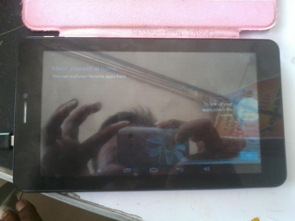

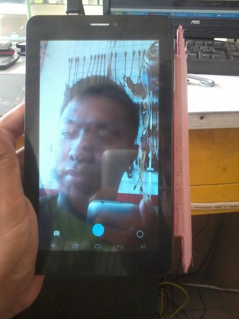

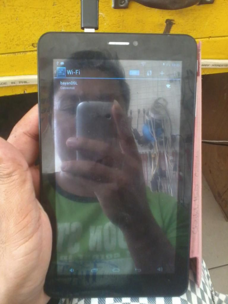

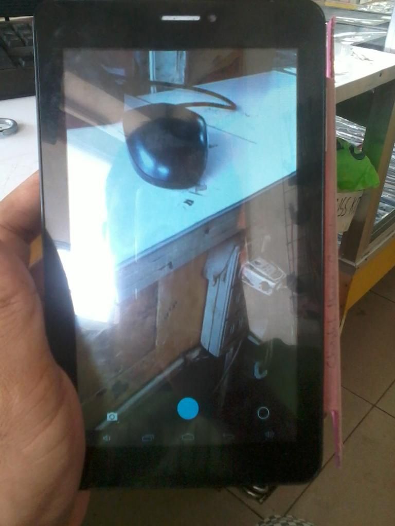

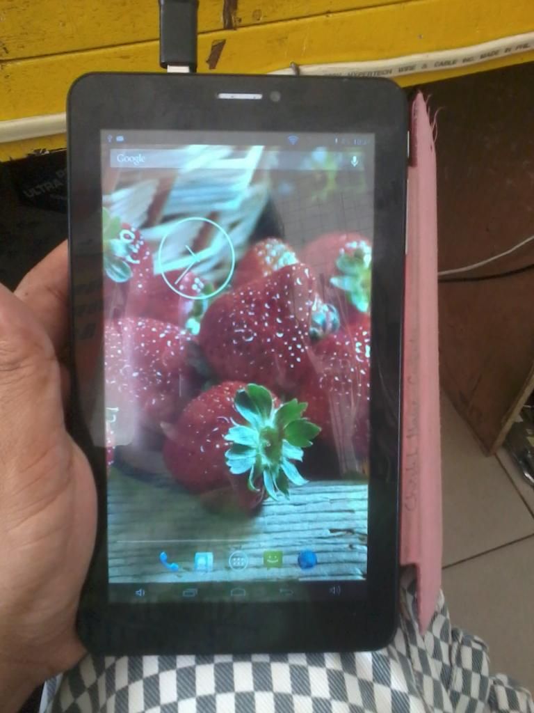

Zentality tablet model:c-704 no power pero detected in pc done via flashing!
board id; a23 cpu
t736_mainboard|_v2.3
materials at firmware;
*flasher phoenixsuit;
http://www.filefactory.com/file/22pt...hoenixSuit_rar
*firmware;
http://www.4shared.com/rar/ZYeXZnnsc...NBOARD-V23.htm
procedure ang image;

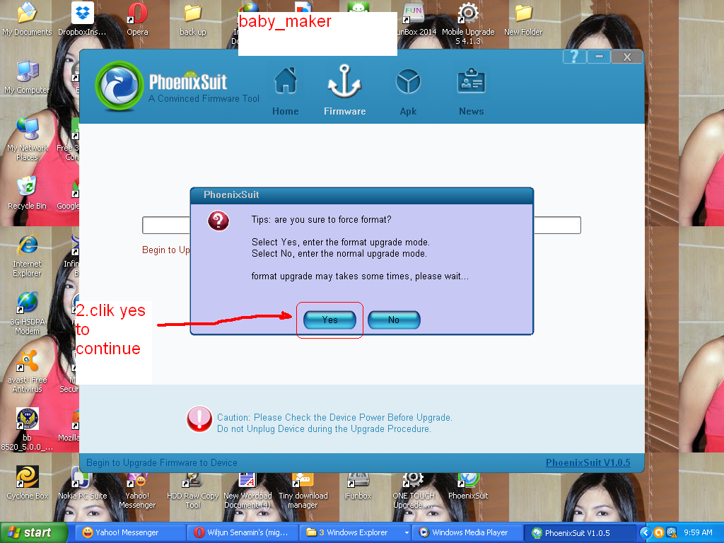

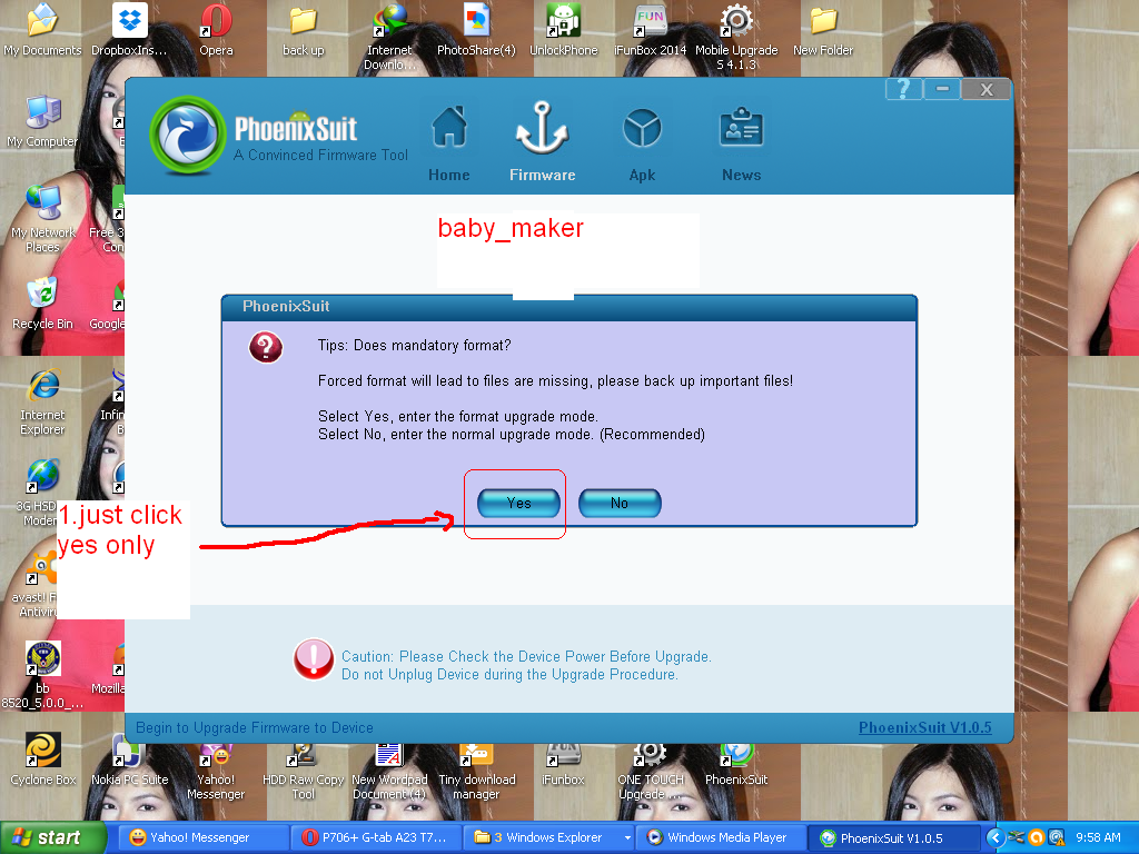

*open phoenixsuit
*click firmware and put firmware
*hold vol - then insert usb
*wait my lumabas na yes or no
*just select always yes

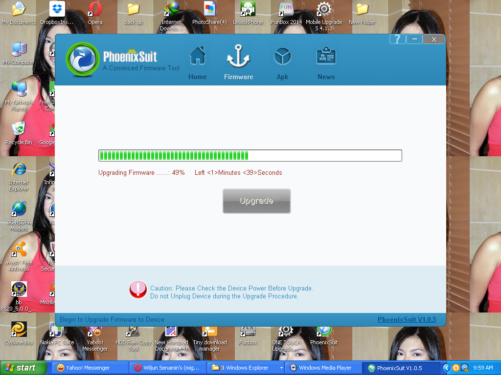

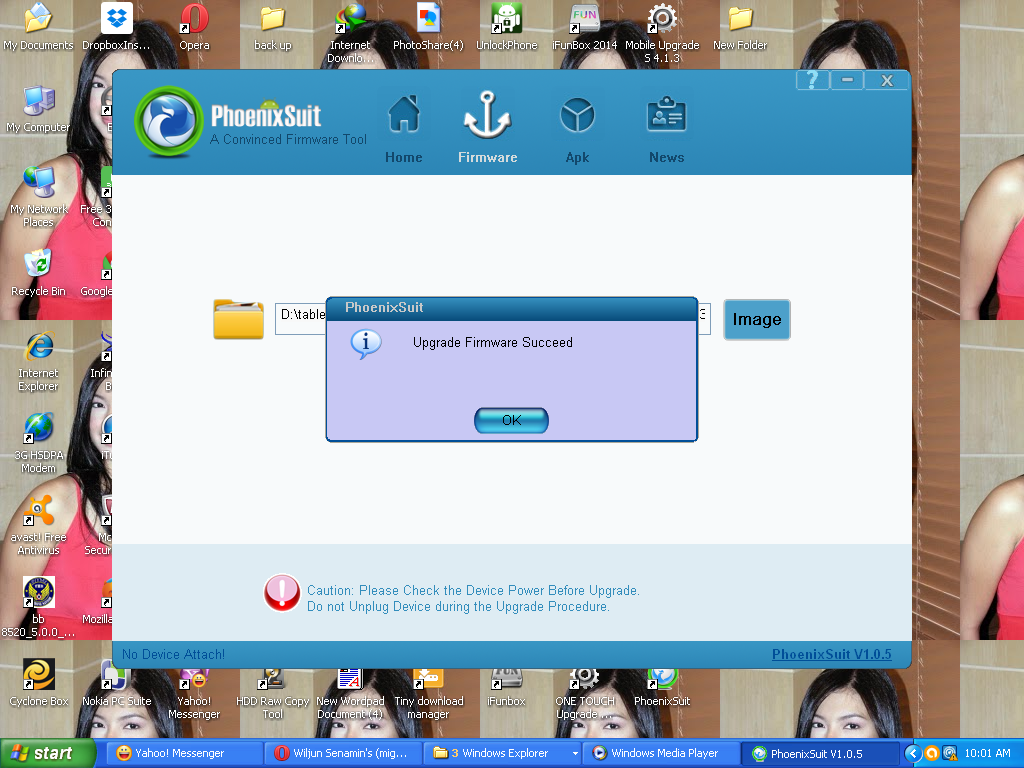

*wait until done
like this;
1.
2.
link;

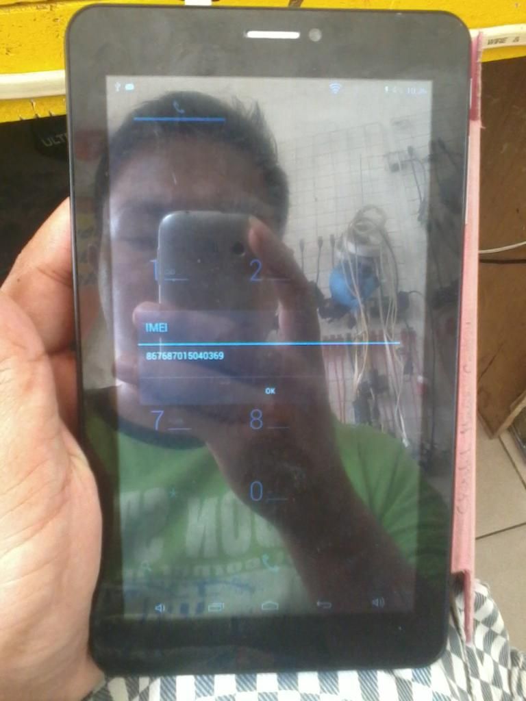

ok po lahat
2 cam,wifi,sim at sensor
hope makatulong,,,
