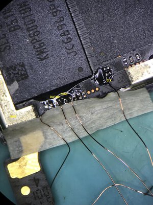

open unit

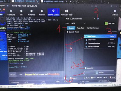

connect isp pin out ( no need vccq just connect battery )
open hydra maintool
emmc direct tab

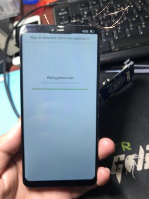

click service tab > emmc info > safe format ( check removed frp )
click execute

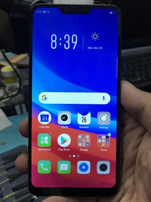

wait til done then power unit
