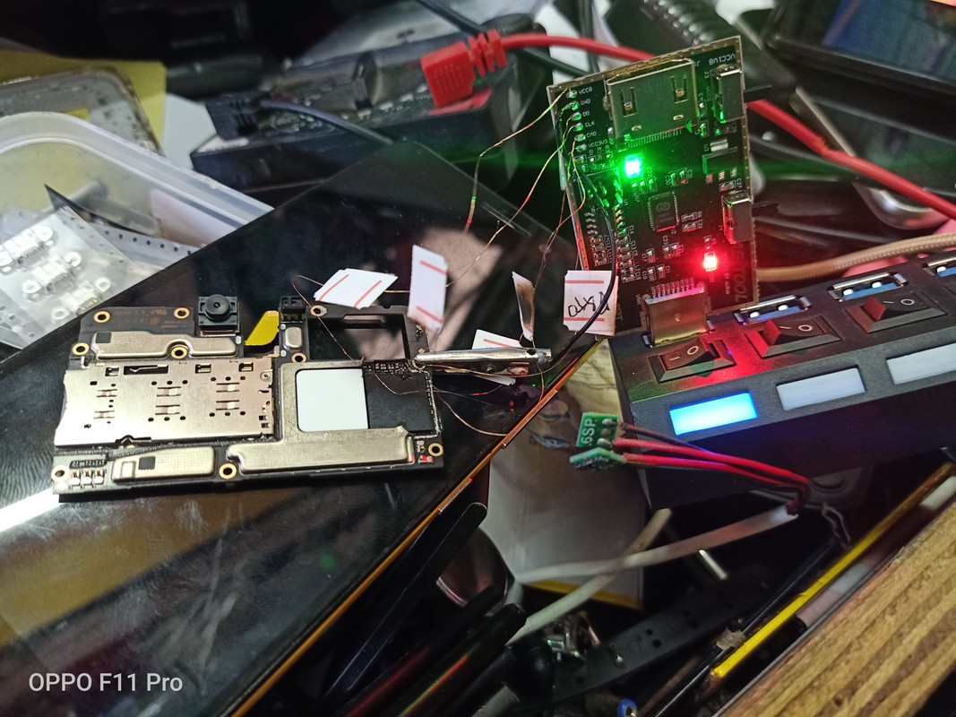

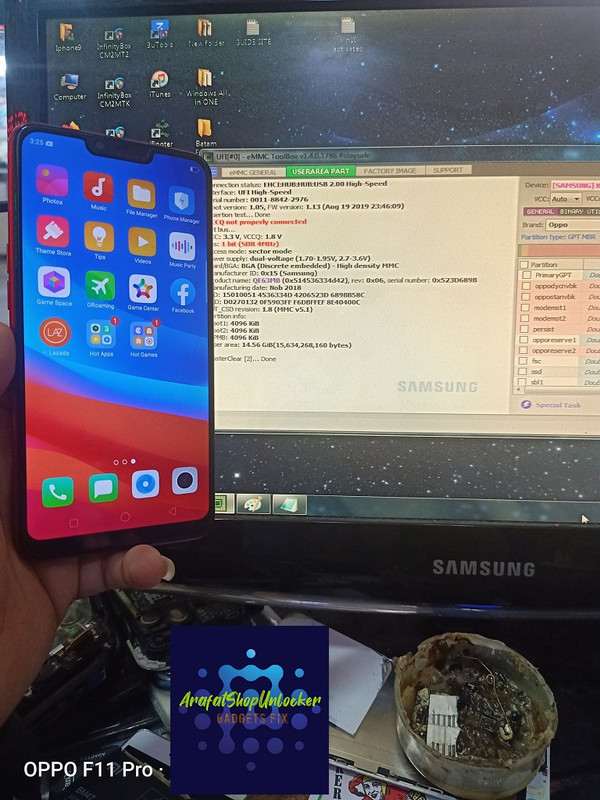

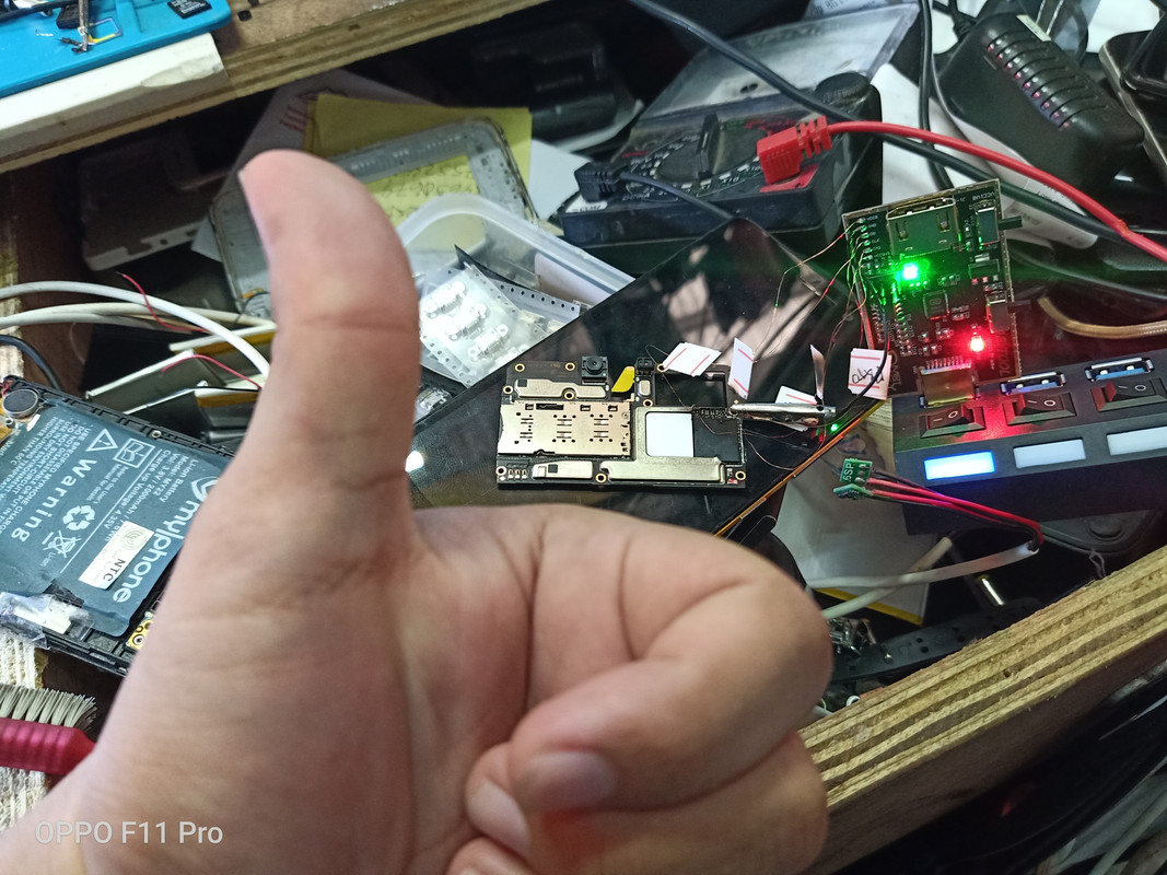

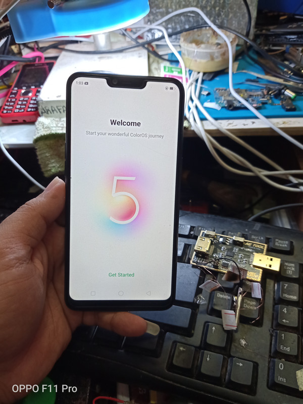

Share ko lang OPPO A3S PASSWORD powered by AETOOL (Tested)
bagong dating itong toys ko napasabak agad...

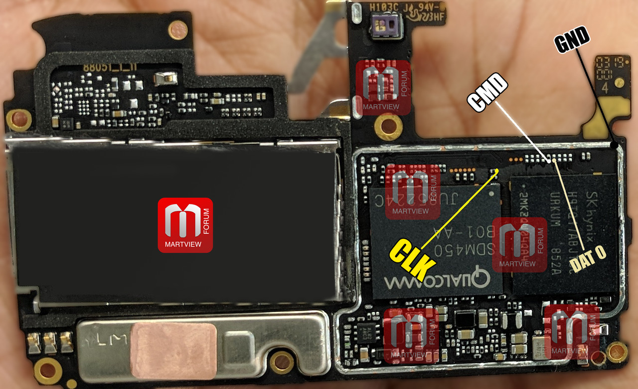

note: dapat tama po ang pinout nakahinang mabuti,sa una kinabahan ako kc ayaw na nya mabuhay laging fail.
Procedure
dismantle unit
pinout (Vccq,Gnd,Do,Clk,Cmd,Vcc)
READ info
FORMAT
Done!
