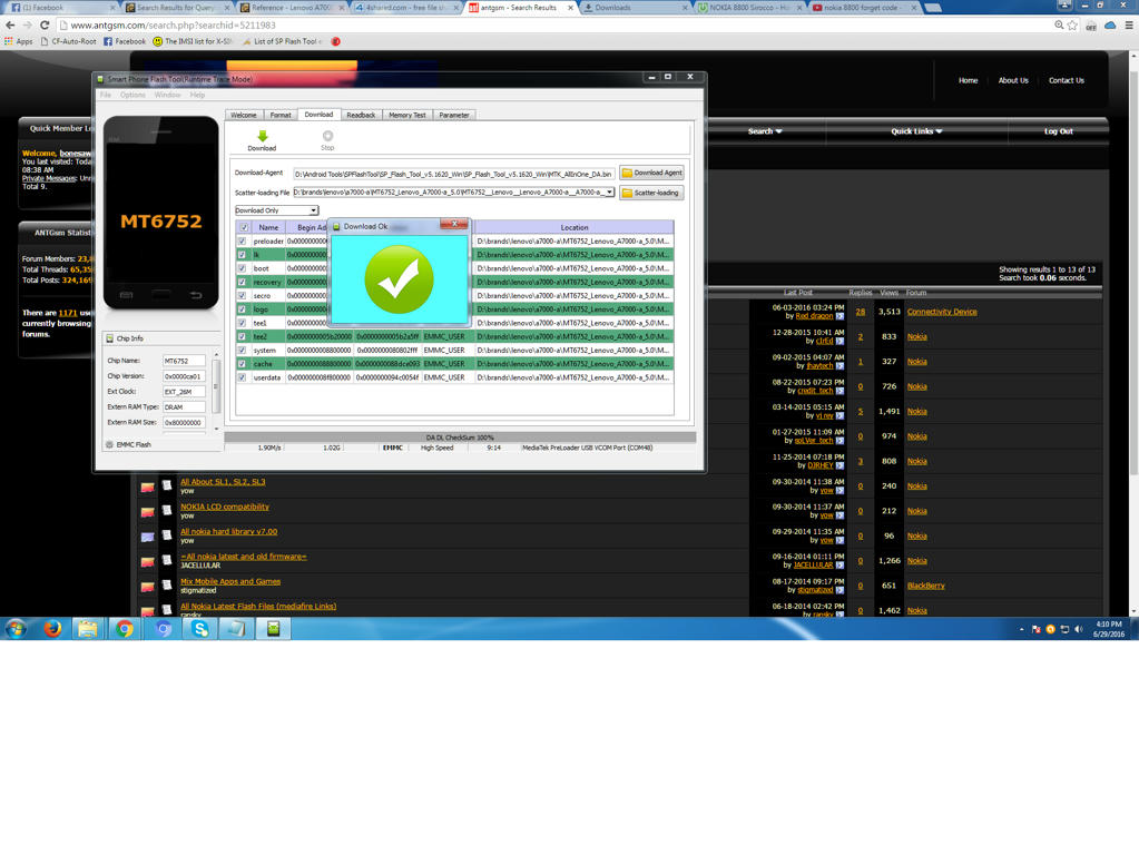

;)history=nagupdate daw may ari tapos pag reboot di na makapunta sa MENU hanggang recovery nalangProceed sa flashing:firmwarehttp://www.mediafire.com/download/krh06m5a84c75co/MT6752_Lenovo_A7000-a_5.0.rar[/COLOR]

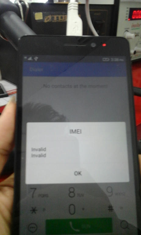

invalid po imei pagkatapos sa flashing..kaya alams na next move..https://www.mediafire.com/convkey/7206/5xv4aw1hrtlz6d26g.jpg
http://www.mediafire.com/download/lvbv86vr6aro1pc/Chamelephon_1.0_apk-dl.com.apk yan po gamit ko DL nyu nalng..[/COLOR]
