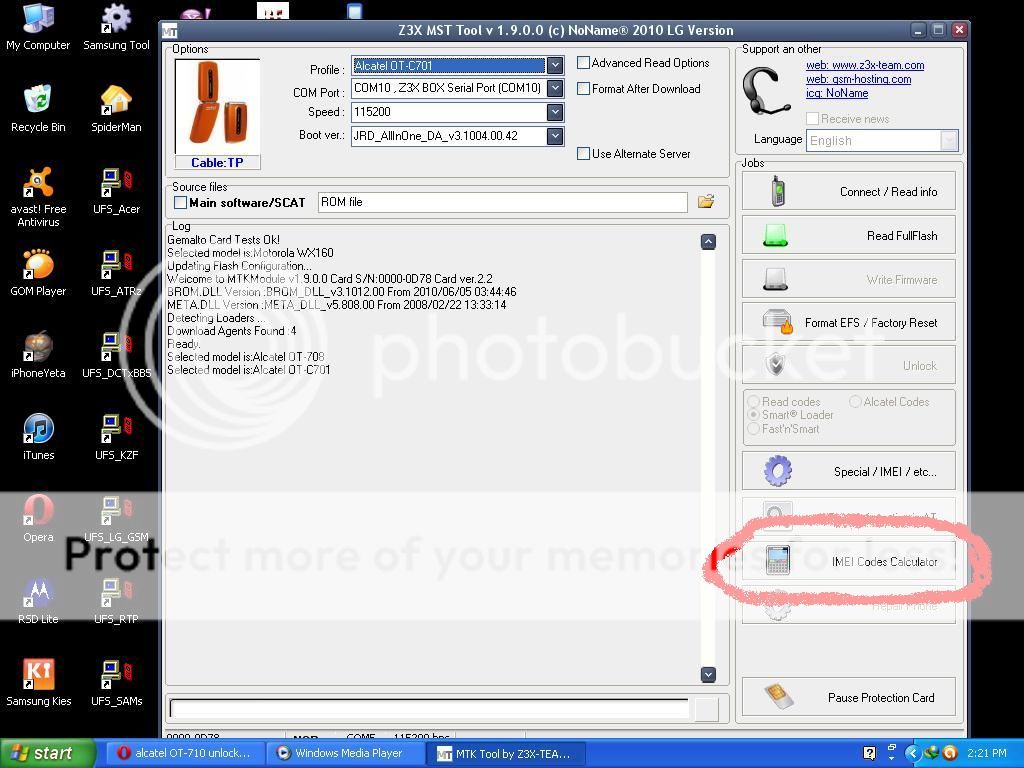

*open mst tool
*select model OT-701
*click imei codes calculator
*enter phone model
*enter provider id

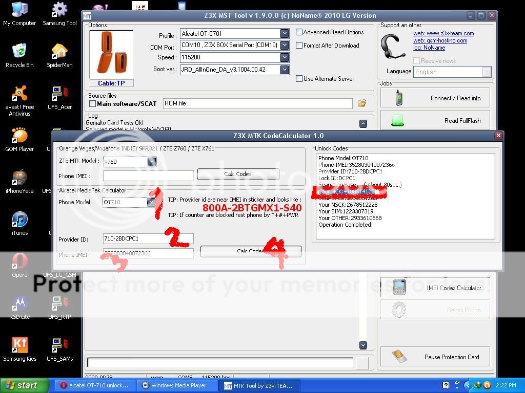

*enter phone imei
*click calc codes
*wait until the nck code read..
then enter the nck code to phone
DONE
