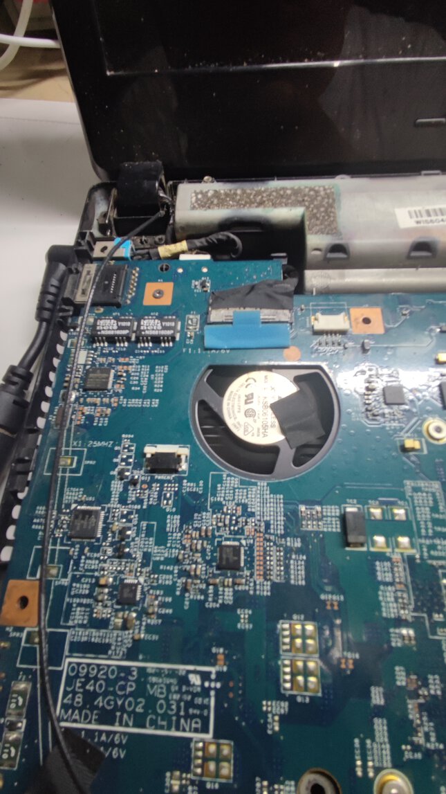

Issue : auto on kapag sinaksak ang charger stop ilang sec tapos on ulet may time kapag ginalaw mismo yung socket ng charger magdidisplay at magboboot
basic troubleshoot ram check okay tanggal cmos wifi card tester ko nadin charger may palo naman
try mo muna disable power switchs nya boss kung mag out restart ba baka grounded ang switchs..
