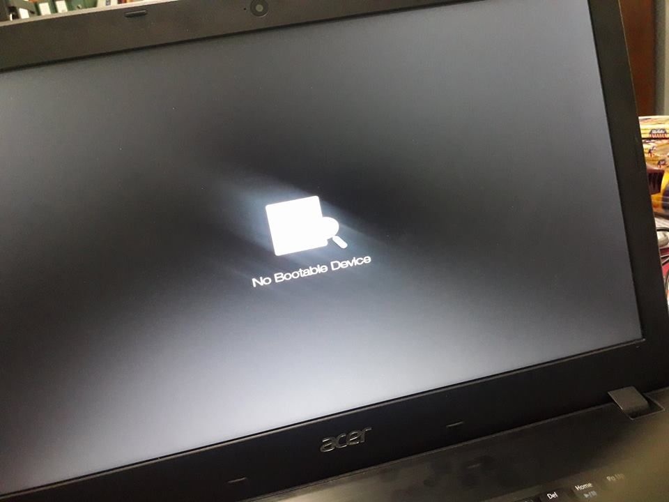

ACER ASPIRE ES1-332 no bootable device found problem..
secure boot ON and OFF no luck..
no IEFI/UEFI option for usb legacy boot kaya hirap ipadetect ng bootable USB ko..
last option!!

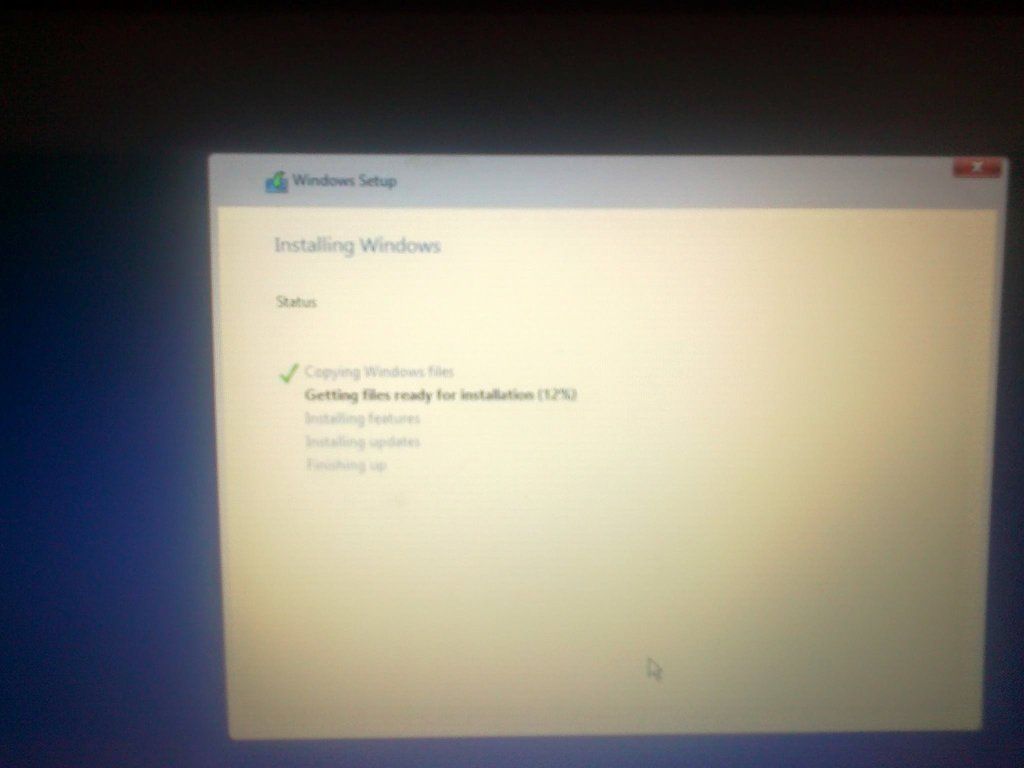

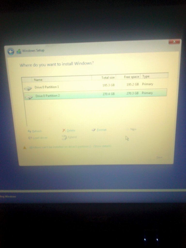

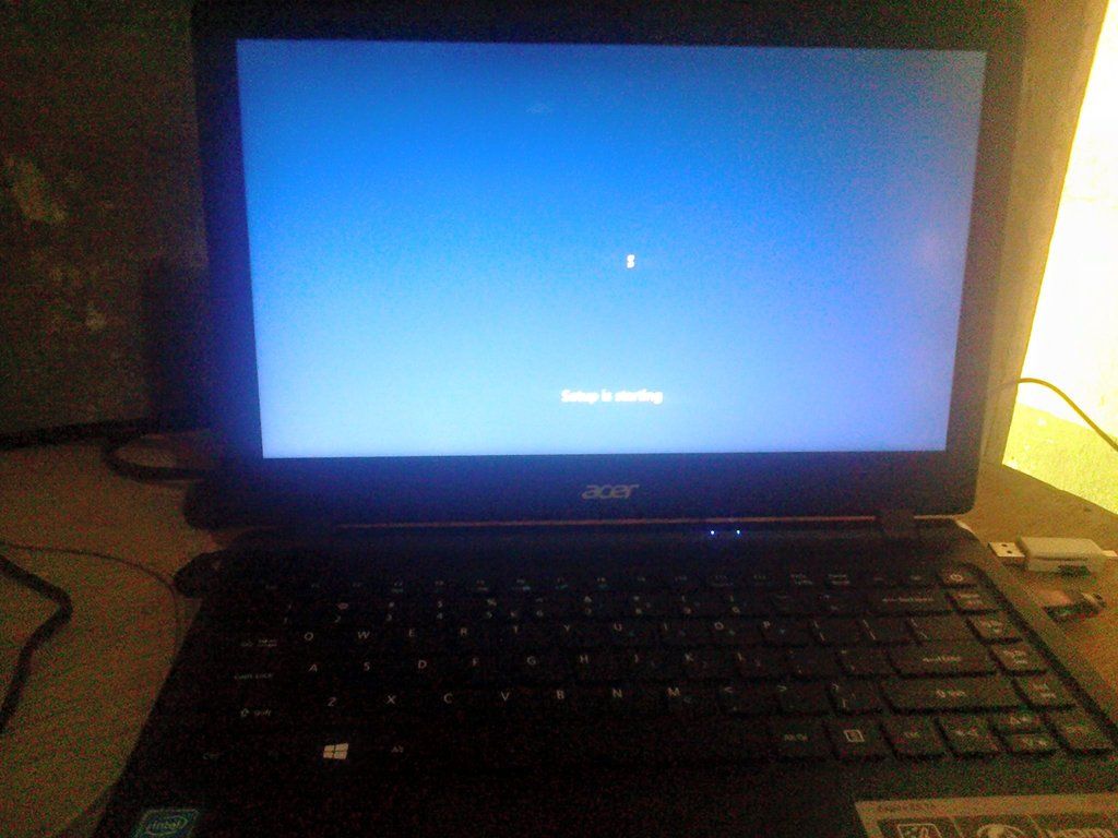

ACTION TAKEN FOR LAST OPTION
1. DL windows OS (in esd form) from trusted website (ALMOST 4GB)
*you can use media creation tool para sa signed OS file
2. create bootable device (IMPORTANT) formatted to FAT32 para madetect ng UEFI/IEFI setting.
then chaaaaraaaaaannnn!!! 500!!! hahahaha
