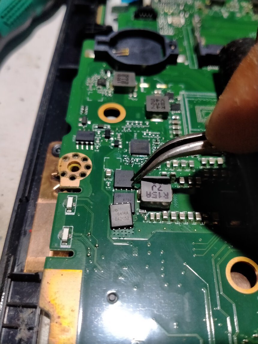

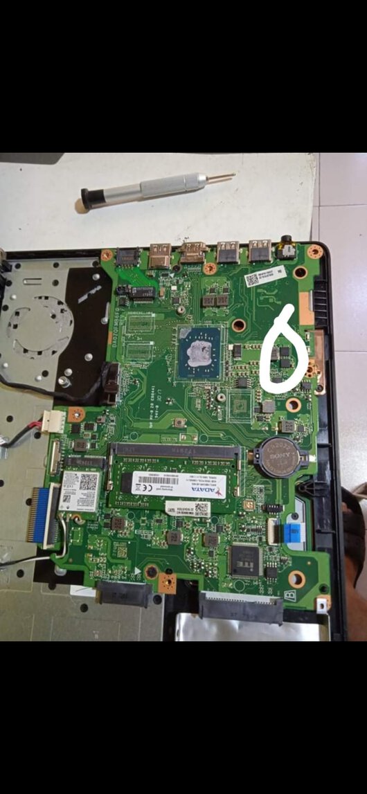

Acer Aspire ES14 No display after ACER logo.
Galing ito sa co-tech:
Action taken:
#Check BIOS Config, nakakapasok nmn at ok din ang settings. Detected din ang HDD. No display prin after ACER Logo.
#change HDD with newly installed OS but still no display.
Solution:
Replaced leak mosfet
MOSFET code: "6414A"
Sana makatulong...
Note: do basic troubleshooting first bago mag come up sa ganitong solution.
Thanks

Common isssue ng ACER ES1-431 eto, madami na din akong nagawa nyan na no display.
