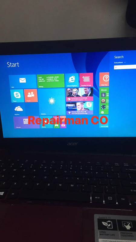

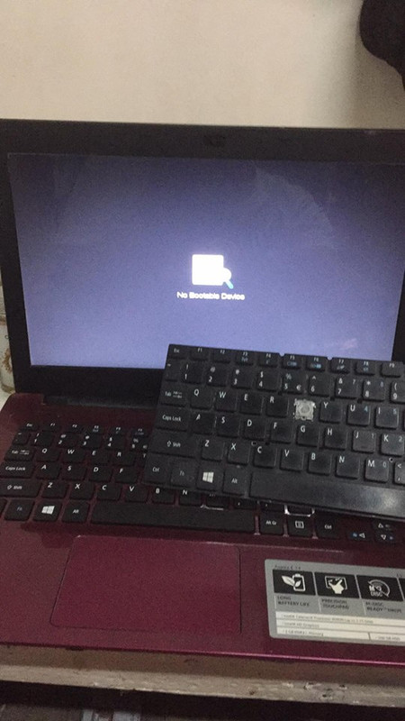

i have some trouble this laptop acer e14, change key board after diagnose its ok well,
but after to change and disassemble unit, whaaaaaat th F"""" i check the hardisk is ok, i resoldering ok, i clean ok, i dont know why what happen!!!
here some solution to share with you

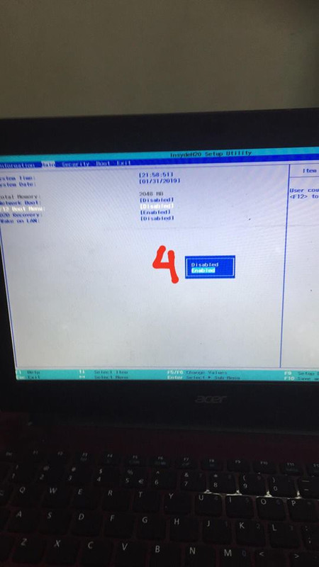

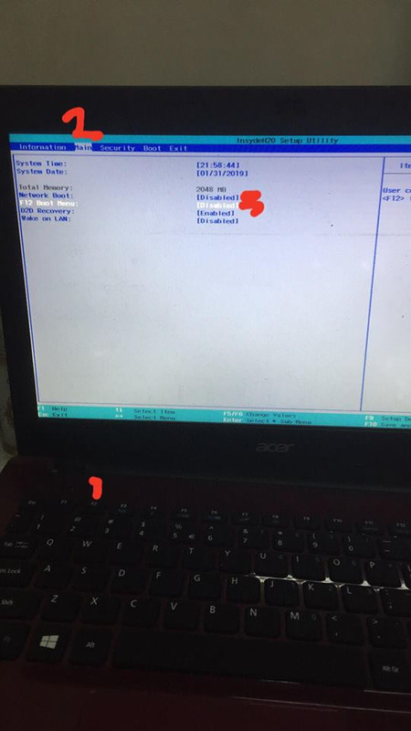

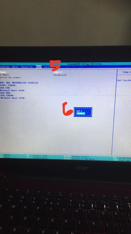

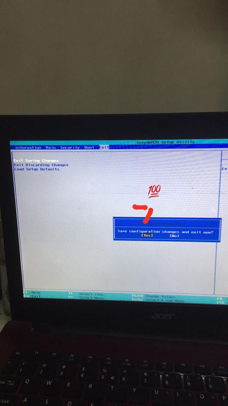

solution
press f12 bago mag open ang screen boot bios
done
