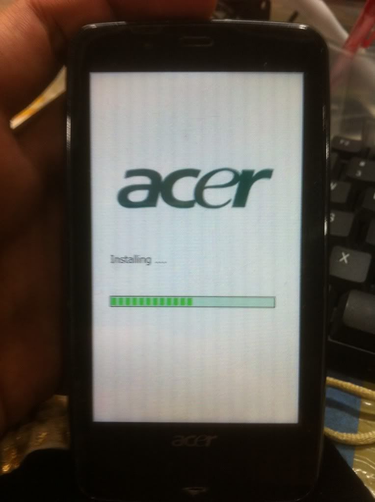

eto po unit mga bos hang lng po sa windows mobile
procedure: Press the reset button while holding
the power button down. When you
see the Acer screen, press and hold the
Record button. You will see a screen
asking you to confirm the clean boot, press the camera button
to confirm."
then after a minute

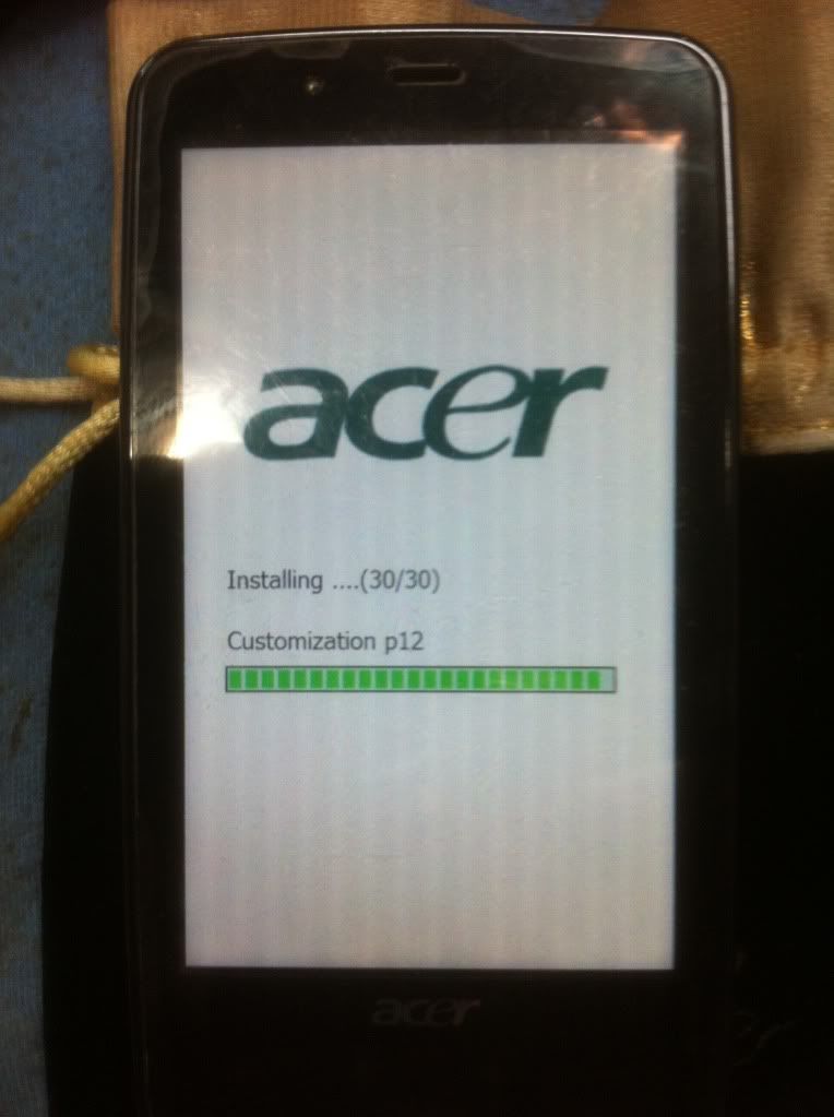

eto na po xia mga idol installing na po xia w8 nio lng po matapos hangang 30 1to 30 po kc installing nia

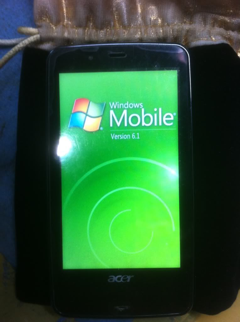

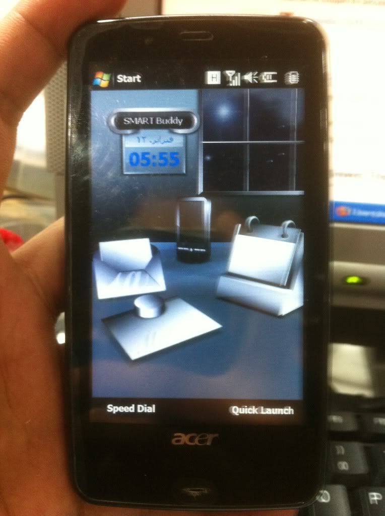

at pag katapos po nia mag install eto na po unit
