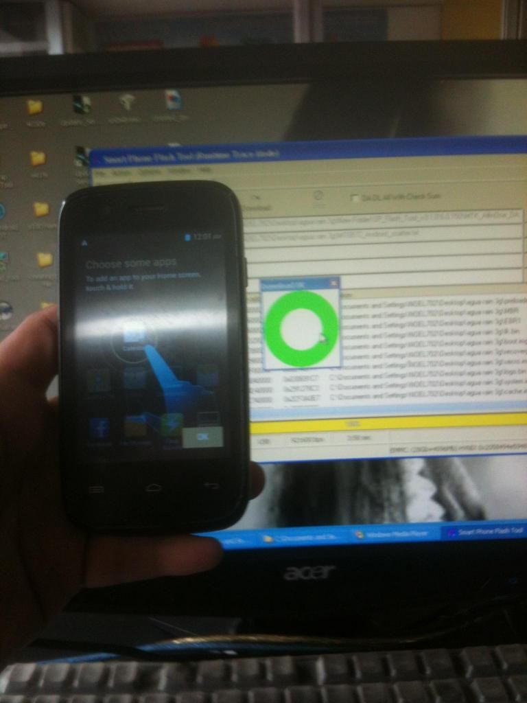

ito na po ang isadang nahuli ngayong umaga
agua rain 3g logo then white screen na paulit ulit done

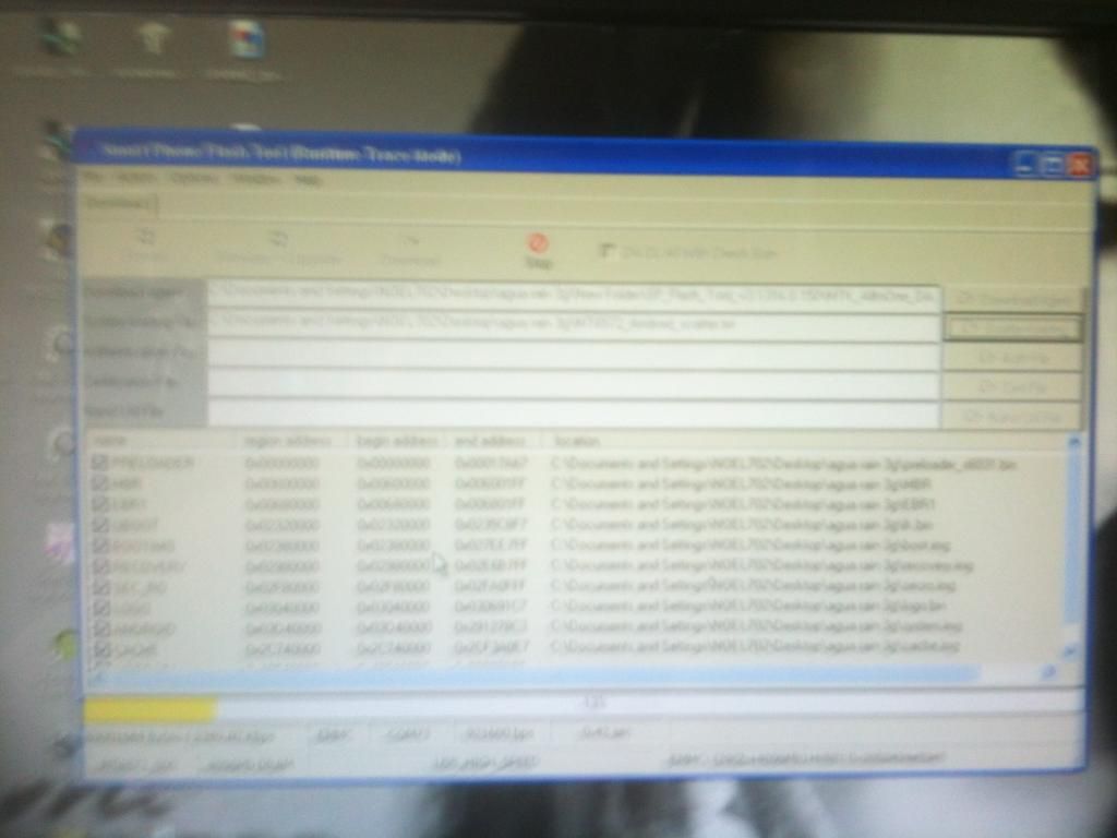

FLASHTOOL:
http://www.4shared.com/zip/KxSRKD5A/SP_Flash_Tool_exe_v313160150.html
=PROCEDURE=
1-FULL CHARGE BATTERY PARA WALANG HUSTLE
2-OFF UR PHONE LAGAY BATTERY AND HOLD VOL.UP
3-CLICK DOWNLOAD AND CLICK YES PAGMAY LUMABAS NA INFO
4-SALPAK USB WAIT TILL FINISH
DONE

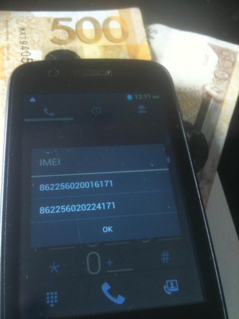

GOOD IMEI:
SANA MAKATULING PO SATIN SALAMAT

using SP_Flash_Tool_v3.1332.0.187
