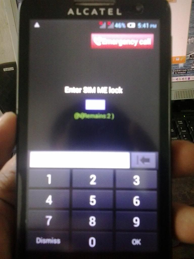

Alcatel 5035e lock sya sa Sun Cellular unlocked by NCK Box

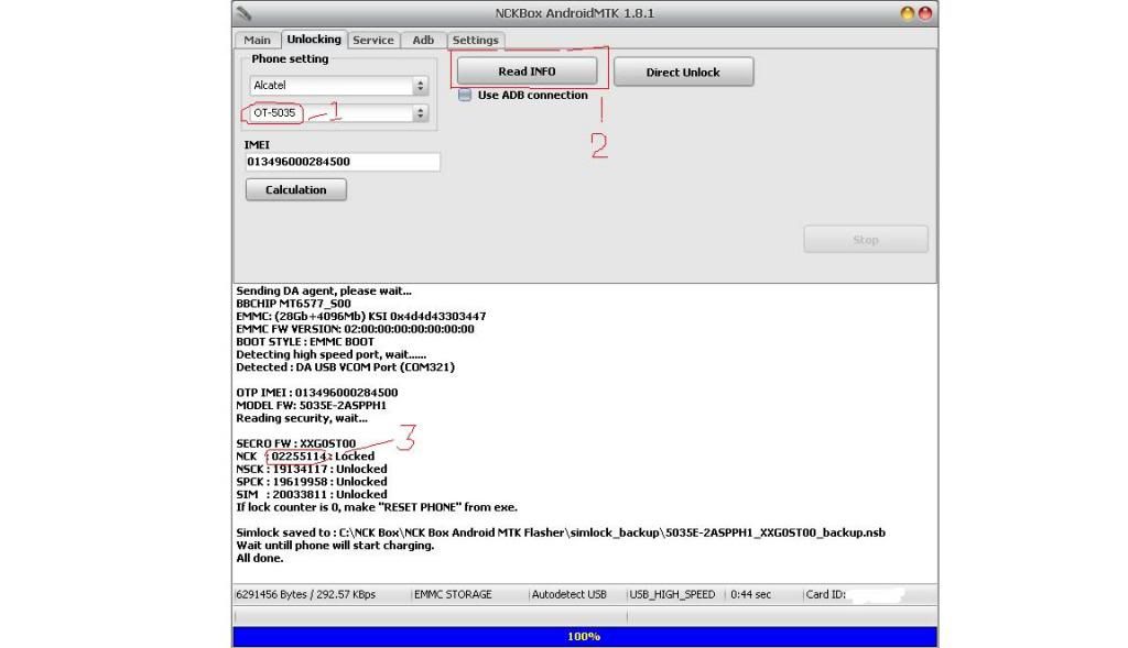

1. Select model 5035
2.Turn off phone and insert usb cable install drivers. Click "Read Info".
3.Insert non accepted simcard and enter the NCK Code.
done! naka Globe sim na sya.
