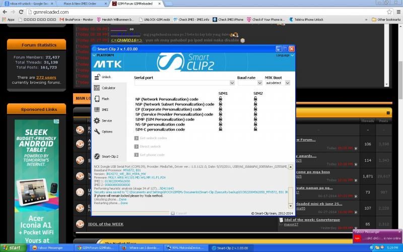

unang try normal unlock mode.
open smart clip 2 software.
select MTK.
connect power off phone to PC.
select Mediateck Port.
click DIRECT UNLOCK.
insert sim, pero LOCKED SIM pa rin. kaya proceed tayo sa YODA METHOD.

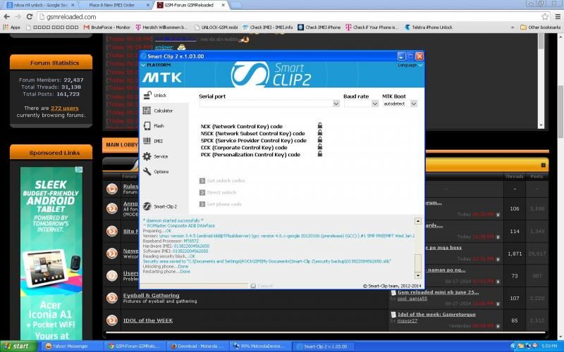

power on phone. select adb access sa developers option.
ROOT phone with Kingo ROOT.
select MTK tab.
select ADB port.
walang lusot sa YODA METHOD!
yun lang po....salamat po!
