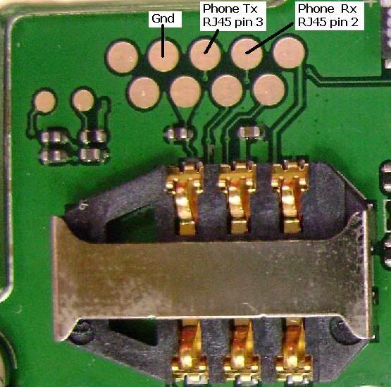

708x unlock
pinout

206x unlock
same pinout
