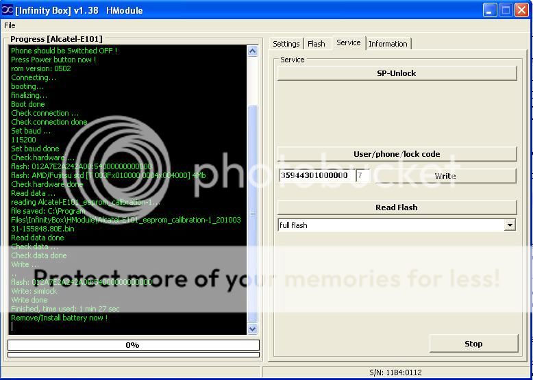

alcatel e101 unlocked!!! may natira pa pala
tools:
-infinity box
-alcatel e100 cable
procedure?
-connect cable then tick SP-UNLOCK
COM9 [VCP0] selected
module v1.38
Device: Alcatel-E101
"advanced chip detection" active
Action: unlock
Checking data, wait...
Boot ...
Phone should be Switched OFF !
Press Power button now !
rom version: 0502
Connecting...
booting...
finalizing...
Boot done
Check connection ...
Check connection done
Set baud ...
115200
Set baud done
Check hardware ...
flash: 012A7E2A242A00:54000000000000
flash: AMD/Fujitsu std [T 003Fx010000 0004x004000] 4Mb
Check hardware done
Read data ...
reading Alcatel-E101_eeprom_calibration-1...
file saved: C:\Program Files\InfinityBox\HModule\Alcatel-E101_eeprom_calibration-1_20100331-155848.80E.bin
Read data done
Check data ...
Check data done
Write ...
Write: simlock
Write done
Finished, time used: 1 min 27 sec
