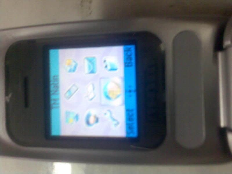

status recieved: lock sa smart...

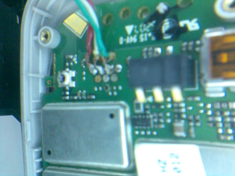

pinout:
finish product:

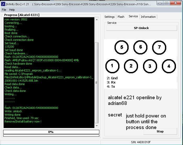

logs:
COM7 [VCP0] selected
Device:
"advanced chip detection" active
Action: unlock
Checking data, wait...
Boot...
Phone should be Switched OFF !
Press Power button now !
rom version: 0502
Connecting...
booting...
finalizing...
Boot done
Check connection...
Check connection done
Set baud...
115200
Set baud done
Check hardware...
flash: 012A7E2A242A00:54000000000000
flash: AMD/Fujitsu std [T 003Fx010000 0004x004000] 4Mb
Check hardware done
Read data...
reading Alcatel-E221_eeprom_calibration-1...
file saved: C:\Program Files\InfinityBox\HModule\backup_Alcatel-E221_eeprom_calibration-1_20081001-141525.80E.bin
Read data done
Check data...
Check data done
Writing...
Write: simlock
Writing done
Finished, time used: 79 sec
Remove/Install battery now !
secret:
hold power switch until the process end...
