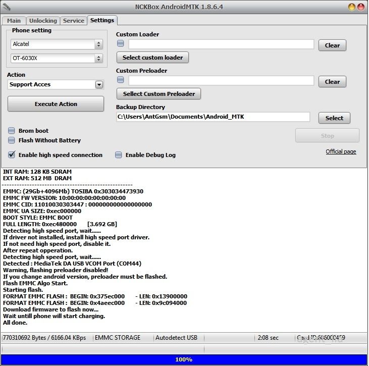

Model: Alcatel Idol A.K.A. Ot6030x
Problem: Hang On Logo
Action Taken: Reprogram
Gadget Used: NCK BOX
Firmware Used: Go To NckBox Support
Code:
 Flash files count is :13
 Action : Firmware update.
 Selected Alcatel: OT-6030X
 Exe version: NCKBox AndroidMTK 1.8.6.4
 Scenario: Flash reset package
 Reinsert phone battery.
 Battery must be charged.
 Phone must be off with battery inside.
 Please insert USB cable now...
 Detected : MediaTek PreLoader USB VCOM Port (COM37)
 Phone detected...Please wait
 Sending DA agent, please wait...
 BaseBand CPU :MT6577_S00
 BaseBand CPU Secure Version : FF
 BaseBand CPU Bootloader Version : 01
 INT RAM: 128 KB SDRAM
 EXT RAM: 512 MB  DRAM
 EMMC: (29Gb+4096Mb) TOSIBA 0x303034473930
 EMMC FW VERSION: 10:00:00:00:00:00:00:00
 EMMC CID: 11010030303447 : 000000000000000000
 EMMC UA SIZE: 0xec000000
 BOOT STYLE: EMMC BOOT
 FULL LENGTH: 0xec480000       [3.692 GB]
 Detecting high speed port, wait......
 If driver not installed, install high speed port driver.
 If not need high speed port, disable it.
 After repeat opperation.
 Detected : MediaTek DA USB VCOM Port (COM44)
 Warning, flashing preloader disabled!
 If you change android version, preloader must be flashed.
 Flash EMMC Algo Start.
 Starting flash.
 FORMAT EMMC FLASH :  BEGIN: 0x375ec000       - LEN: 0x13900000
 FORMAT EMMC FLASH :  BEGIN: 0x4aeec000       - LEN: 0x9c094000
 Download firmware to flash now...
 Wait untill phone will start charging.
 All done.
