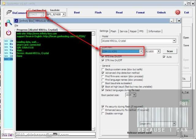

Alcatel KR01 aka CRYSTAL Unlocked Done

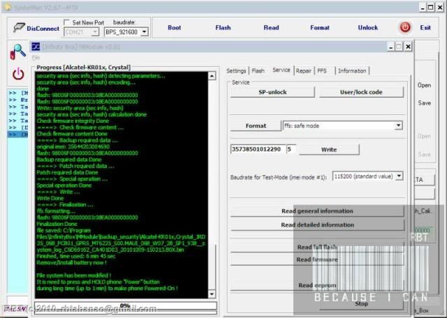

First timeAlcatel KR01 aka Crystal unlocked smoothly with Spiderman/Infinity CombiConnect muna unit sa Spiderman and autodetect pinout...
open Infinity shell and select Alcatel KR01/Crystal
be sure na yung COM port mo sa Infinity same din sa COM ng Spidermanclick SERVICE TAB then SP-unlock...then follow screen instruction..
LOG:

file saved: C:\Program Files\InfinityBox\MModule\backup_security\Alcatel-KR01x,Crystal_JRD25_06B_PCB01_GPRS_MT6225_S00.MAUI _06B_W07_28_SP1_V38__system_log_C6D69162_CA401D03_ 20101009-150213.B0X.bin
Finished, time used: 6 min 45 sec

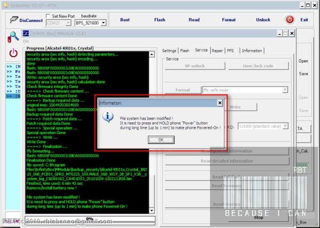

Remove/Install battery now !
File system has been modified !
It is need to press and HOLD phone "Power" button
during long time (up to 1 min) to make phone Powered-On !

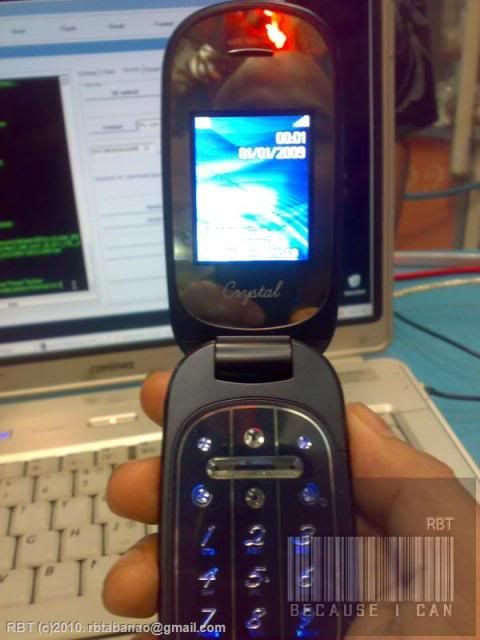

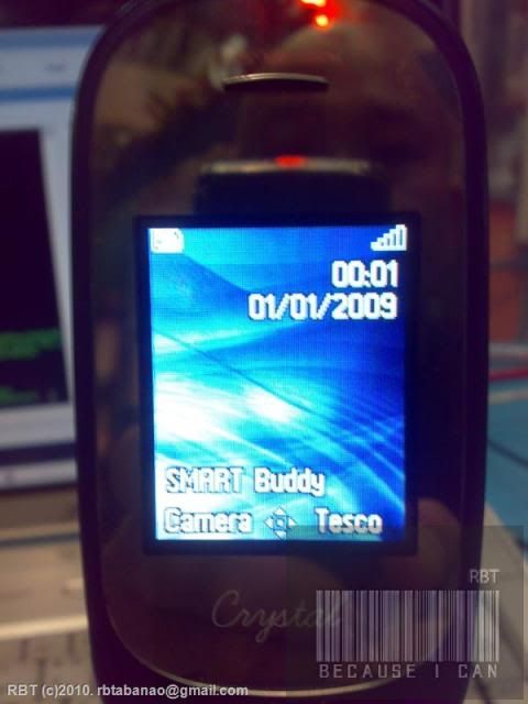

Some screenshot..
LOG:
Some screenshot..
