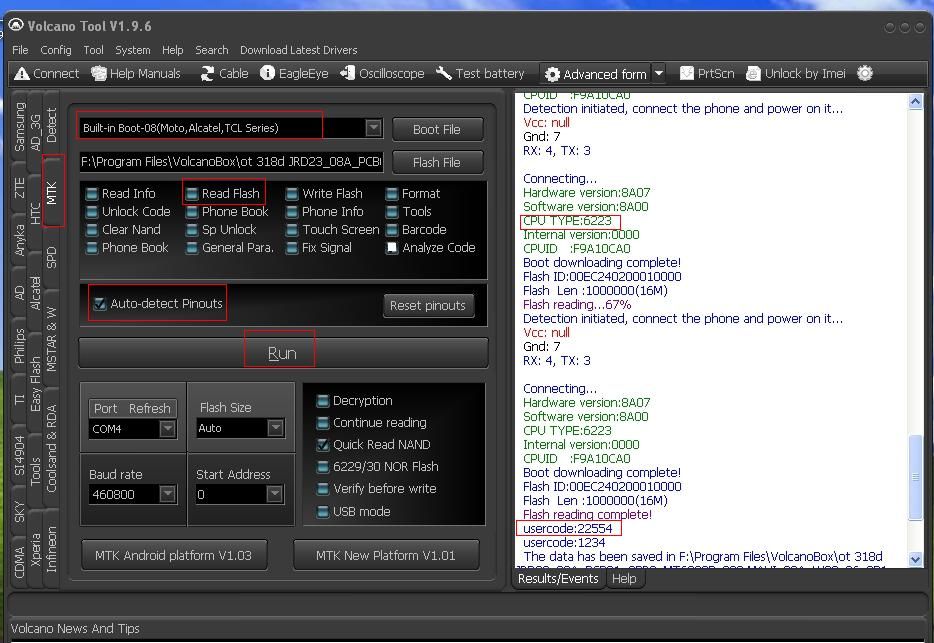

alcatel one touch 318D phonelock! DONE
unit : Alcatel OT 318D
status : phone lock (security code)
Chipset : Chipset MTK 6223C ( ALCATEL ONE TOUCH - Philippines - Products - Feature phones - ONE TOUCH 318D )
tools
volcano box
jip P-07A
procedure
1. connect volcano box, open GUI
2. detect with MTK, set pin out
3. on MTK tab, choose boot 08 (moto,alcatel, tcl series)
4. check auto detect pinout
5. read flash, run
6. DONE!
for reference only, especially to all volcano user!
