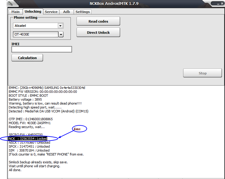

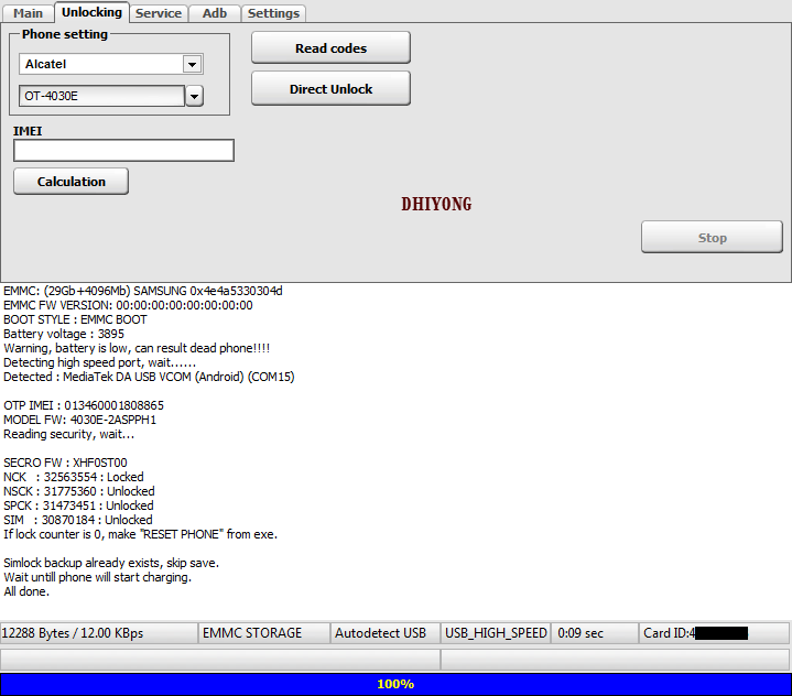

PROCEDURE
root first
matapos ma root
power off the phone
press volume DOWN at VOLUME UP
salpak micro usb cable
install driver if needed
press readcodes
not supported for direct unlock this phone.
eadcodes only
ENTER NCK CODE
#done
