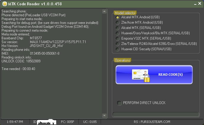

alcatel one touch idol unlock via FG box
needs:
*FG box pack 6 activated
*usb cable (5310)
simple procedure:
*phone must be off
*open MTK code reader.exe
*thick alcatel MTK android usb (model selector)
*thick read codes
*insert usb to phone
*wait until finish

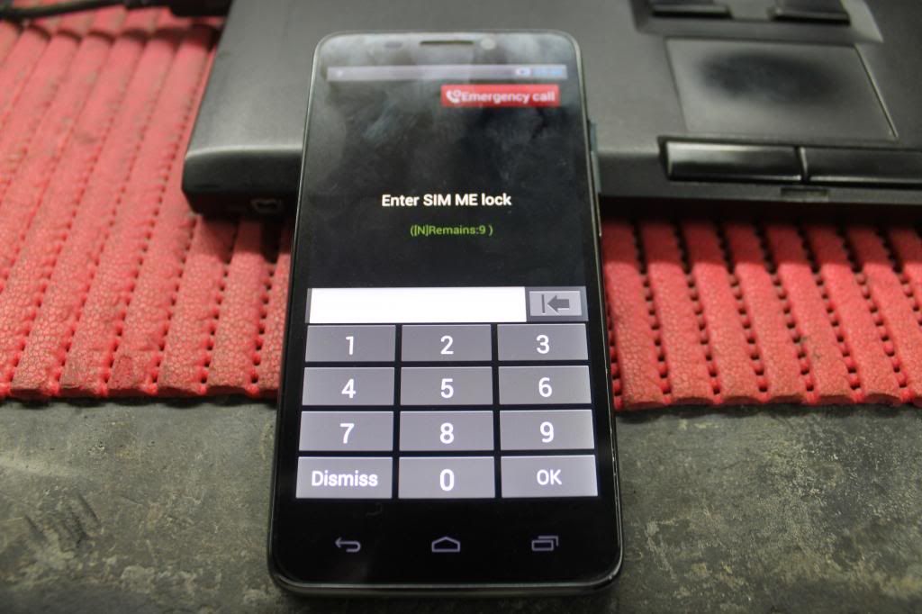

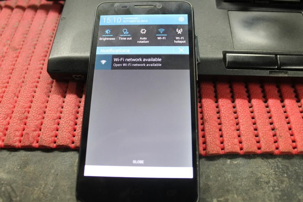

unlocking:
*Turn On The Phone With Sim Inserted (Different From The Orig Carrier Sim)
*enter Unlock code and your done
*don't forget get the payment for ur service
screen shoot:
Click here to view the original image of 689x423px.
logs:
Searching phone;
Phone detected (PreLoader USB VCOM Port)
Preparing to start meta mode;
Searching for debug port; (be sure drivers from support were installed)
Debug Port found on Android Gadget VCOM Driver (COM140);
Preparing to connect meta mode;
Meta mode entered;
Baseband Chip: MT6577
Sw version: MAUI.11AMDW1222SP.V15.F5.P11.T1
Hw Version: JRDSH77_CU_JB_HW
Reading phone info;
IMEI: 013495-00-050061-8
Reading simlock info;
UNLOCK CODE: 18502889
Time needed - 00:00:40
Click here to view the original image of 879x585px.
