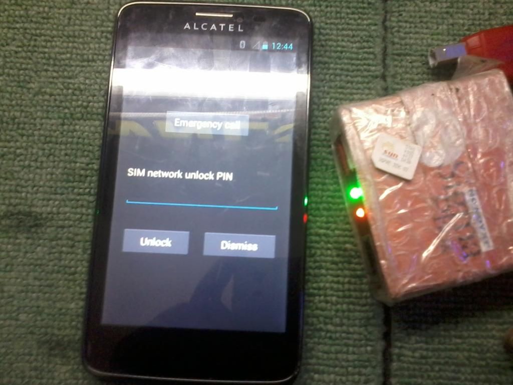

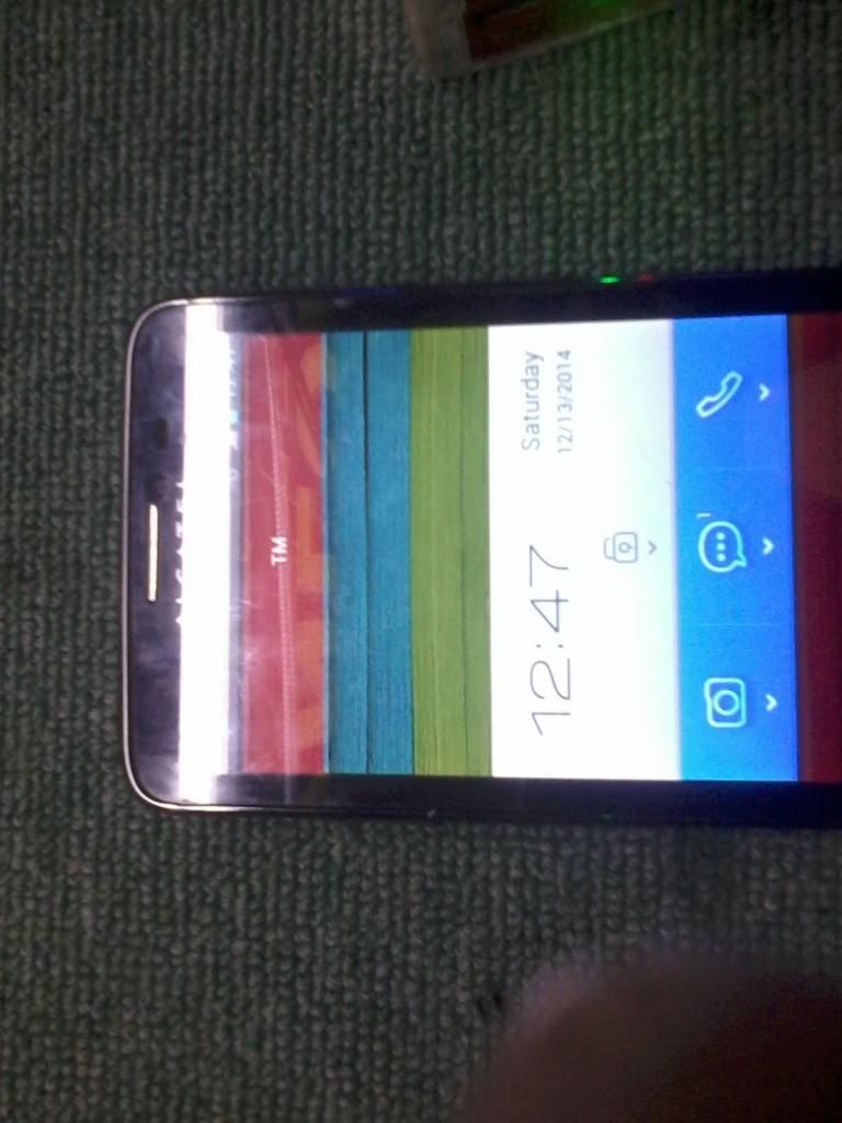

Alcatel One Touch 8000A Lock To Sun Unlock Done

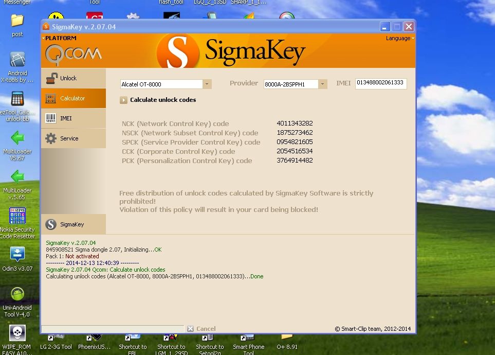

Procedures :
- Open Sigmakey Software
- QCOM Platform
- Calculator
- Select model OT-8000
- Select Provider For SUN ( 8000A-2BSPPH1 )
- Input IMEI
- Tick Calculate Unlock Codes
- Enter Non-Accepted Sim Card
- And The Last Enter NCK Codes
- Unlock Done
DONE.......
