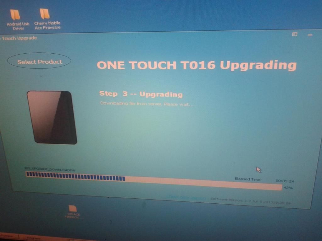

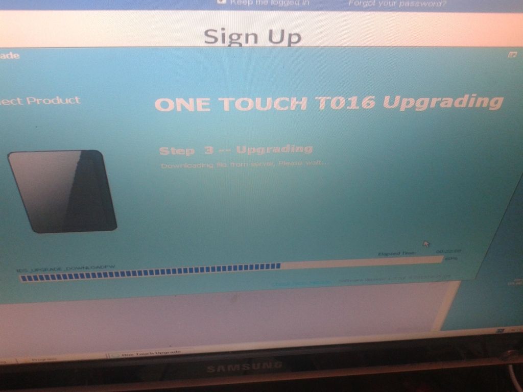

first open po natin yung upgrader tas cliuck select model..

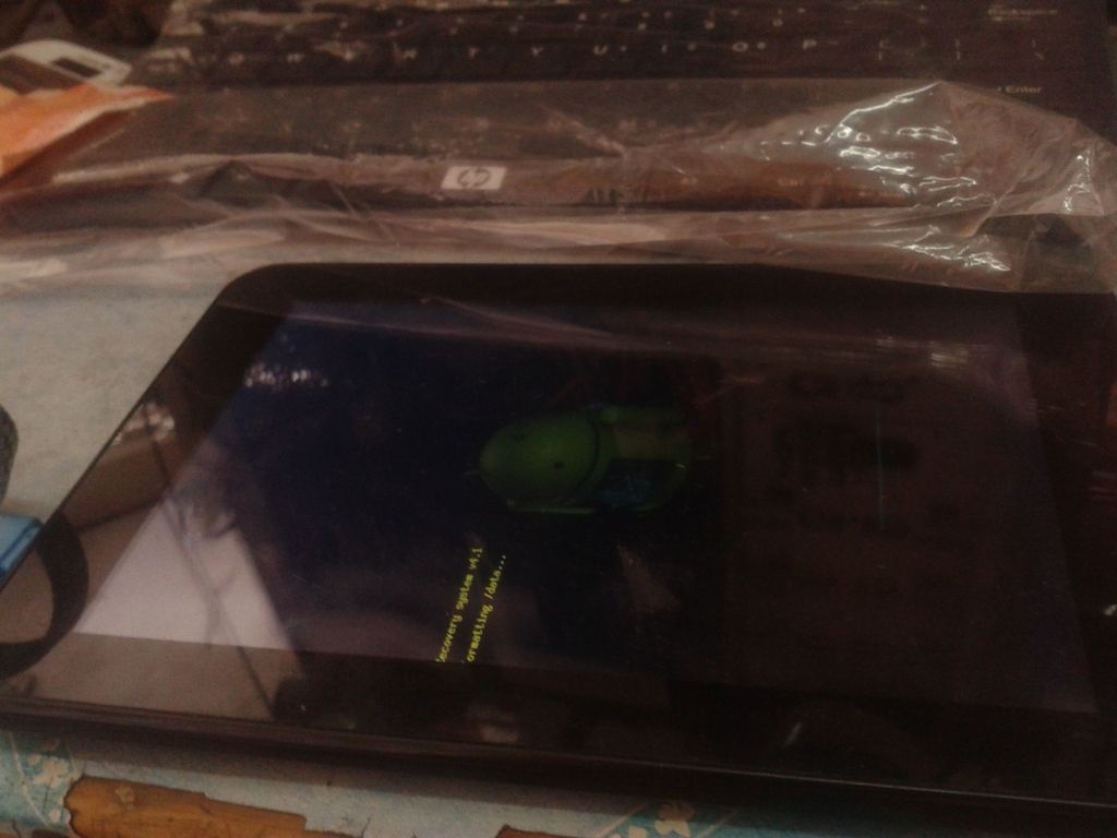

hold volume up tas salpak usb install driver needed
wait lang to finish and download
wala kayo iba gagawin kung di mag antay hanggang lumabas eto

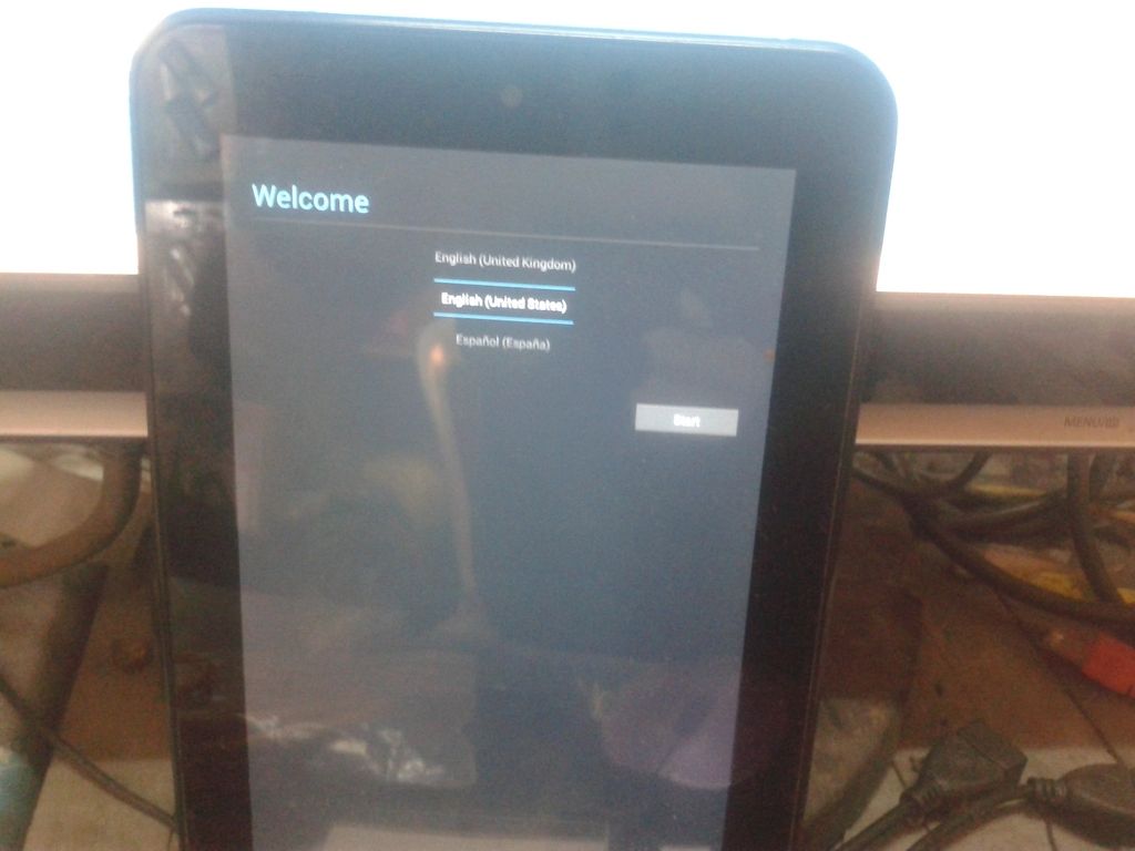

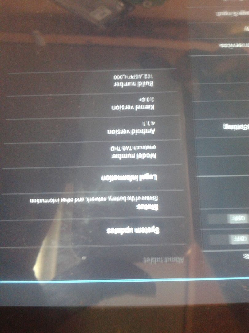

yan tapos na
