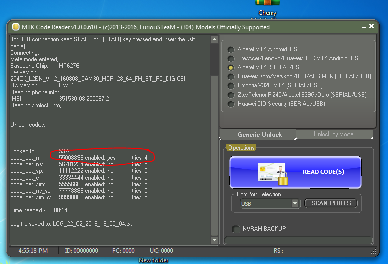

procedure
run the software
pag humingi ng key open nio to
copy paste yung hardware id
then generate
tapos copy nio na yung keygen sa software then register mag oopen na yan
proceed na tayu sa unlocking
choose Alcatel MTK serial/usb
scan ports
then tick usb
then read codes na
turn off phone
hold *
insert usb
wait na lumabas yung code

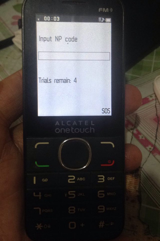

lagyan ng sim
enter lang sa cp yung code
then done
