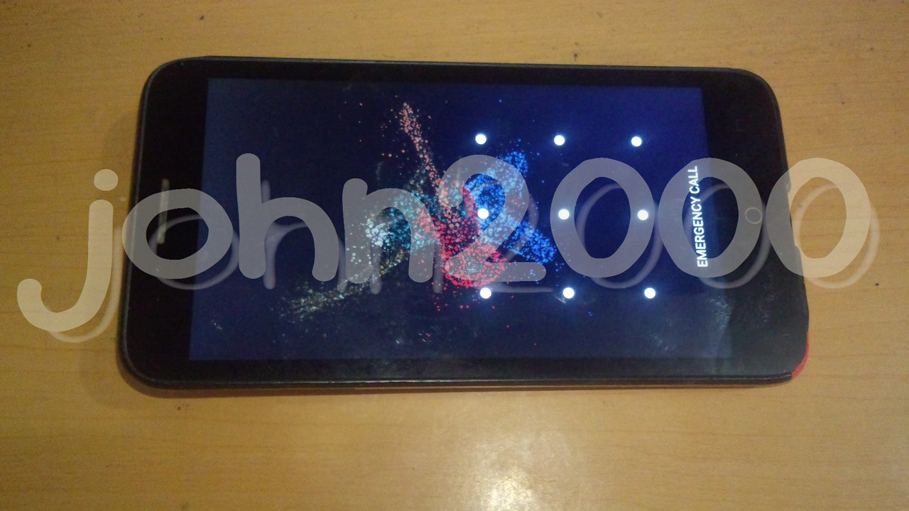

Alcatel OneTouch Go Play 7048x Pattern Lock
History :
Nakalimutan ang Pattern Lock

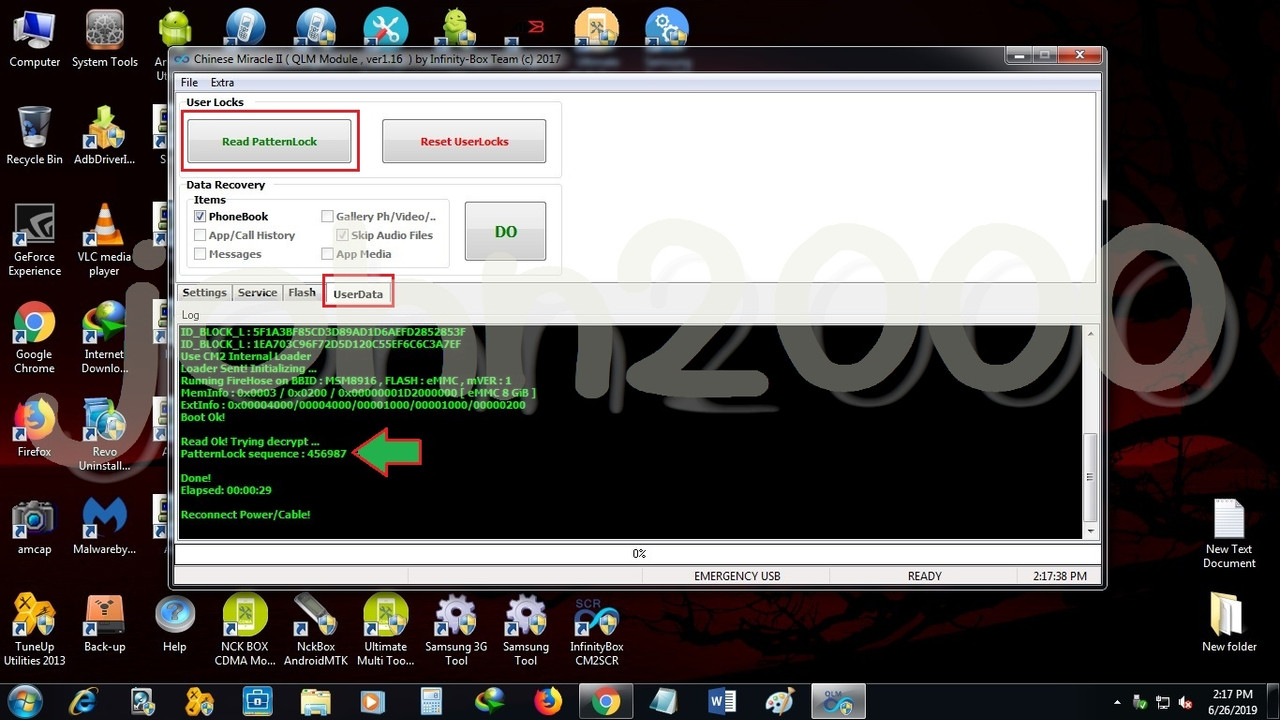

Procedures with Screenshots :
Run InfinityBox CM2QLM ver1.16 GUI
Click UserData Tab
Click Read PatternLock Button
Power Off Device
Insert EDL Cable while Pressing Switch Button
Release Pressing Switch Button when device is detected
Wait till PatternLock Sequence reading done

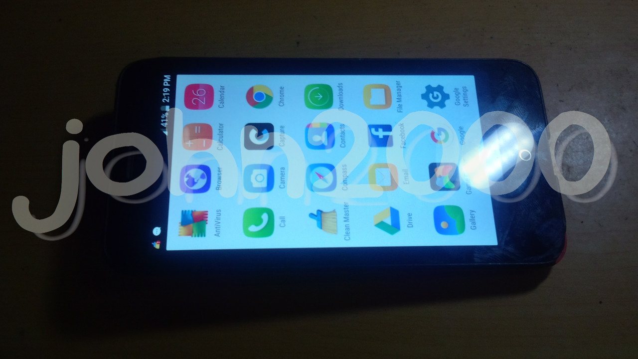

Result :
Done...
