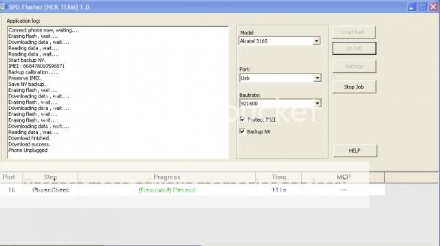

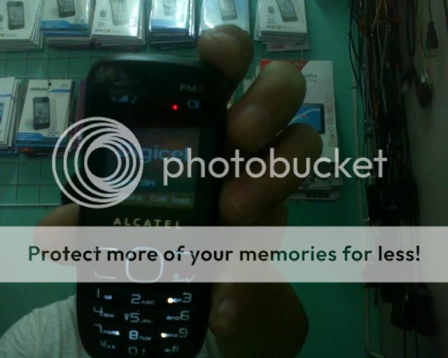

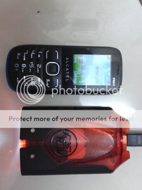

Nag search po ako wala ako nakitang naka unlock
kaya try bagong toy ko
Tools*
*USB CABLE
*NCK BOX

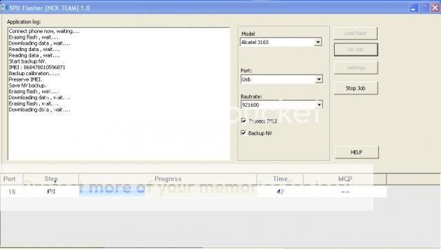

Procedure
*Open nck box soft SPD alcatel
*Download unlocked firmware from support
*Select correct model
*load flash file
*Select usb & set baudrate 921600
*Tick do job
