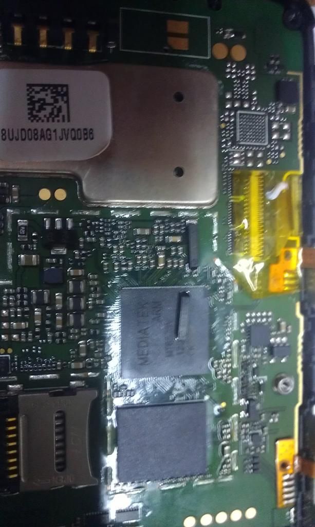

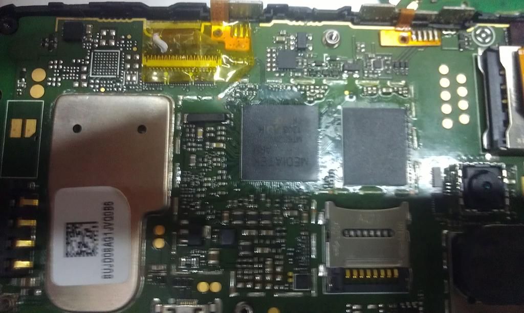

problem:
water damage,
blue light only,
di rin madetect ng PC..
procedure..

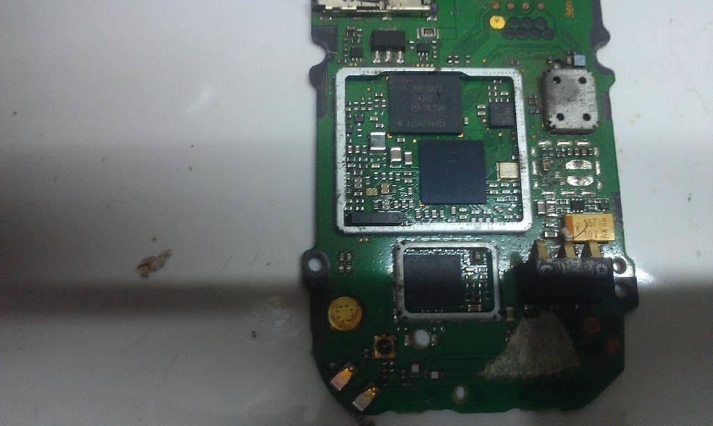

change cystal clock only..
d2 ko kumuha sa nokia c1-01

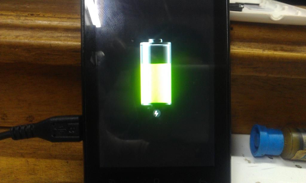

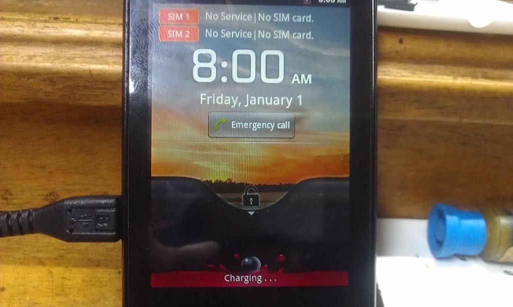

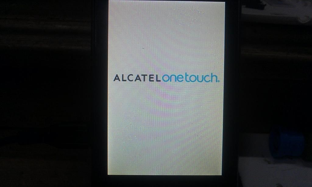

testing..
ayan nag charge n..
ok n unit..
