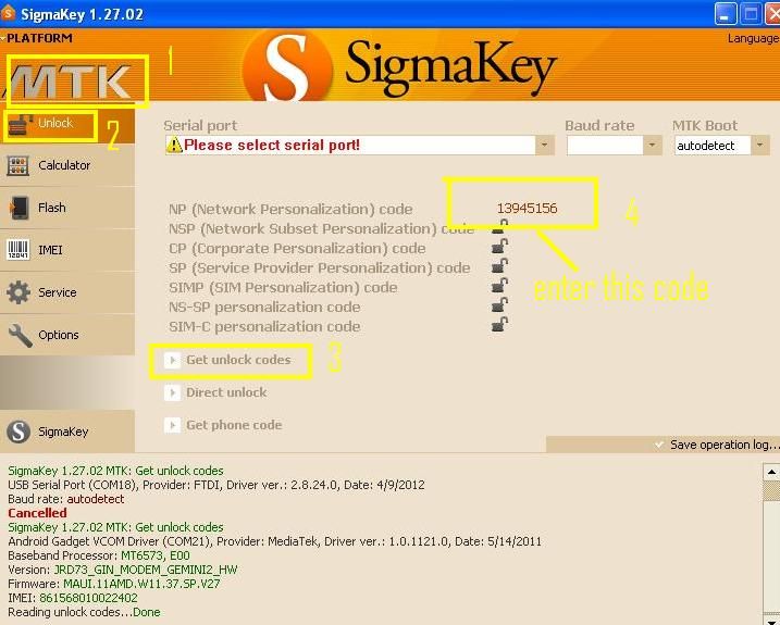

Unlock Alcatel OT-985 using SigmaKey

3.- Open Sigma software and choose MTK platform
4.- Choose com port (will be FTEAM Port)

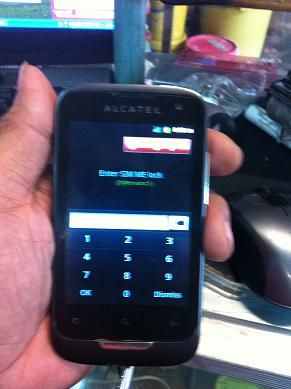

5.- Press Get unlock codes and wait some seconds for codes
6.- Power on phone with incorrect sim card to enter unlock code
