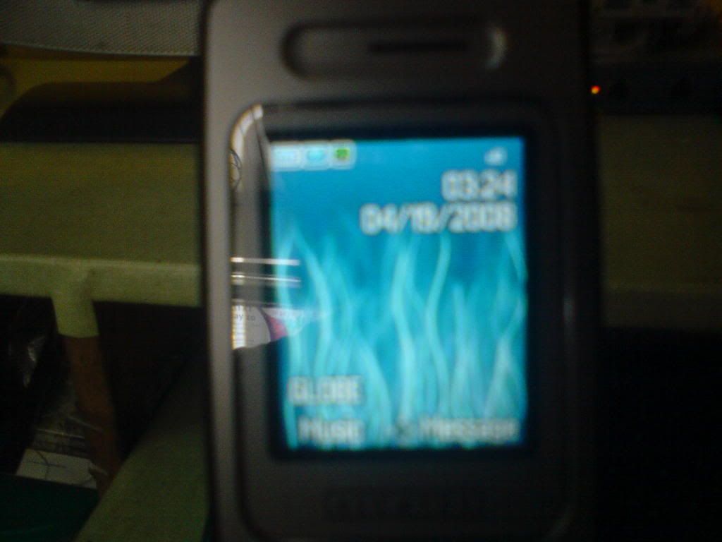

Alcatel OT-C107 Hang Done by Infinity..
COM61 [VCP0] selected
Action: reset settings
Model: Alcatel OT-C701X, OT-C701A
Checking data, wait...
Phone should be Switched OFF !
Press and HOLD Power button now !
19200 autodetect
Initializing[6226:8A03:8A02]...
CPU: MT6226
chip: 0031:B70E:A000
Connecting, wait...
Release Power button now !
Phone detected, wait...
Hardware: MT6226,E03
Date: 2005.04.12
Version: 1.0
Version: MAUI.06A.W06.52.SP1.V17
Version: JRD26_06A_HW
45 byte(s) read
imei: 35320501278339
connection Ok
warning: wrong packet cs
building list...
done
items to clear: 348
322 of 348 items cleared
building list...
done
26 items remains
Finished, time used: 162 sec
Remove/Install battery now !

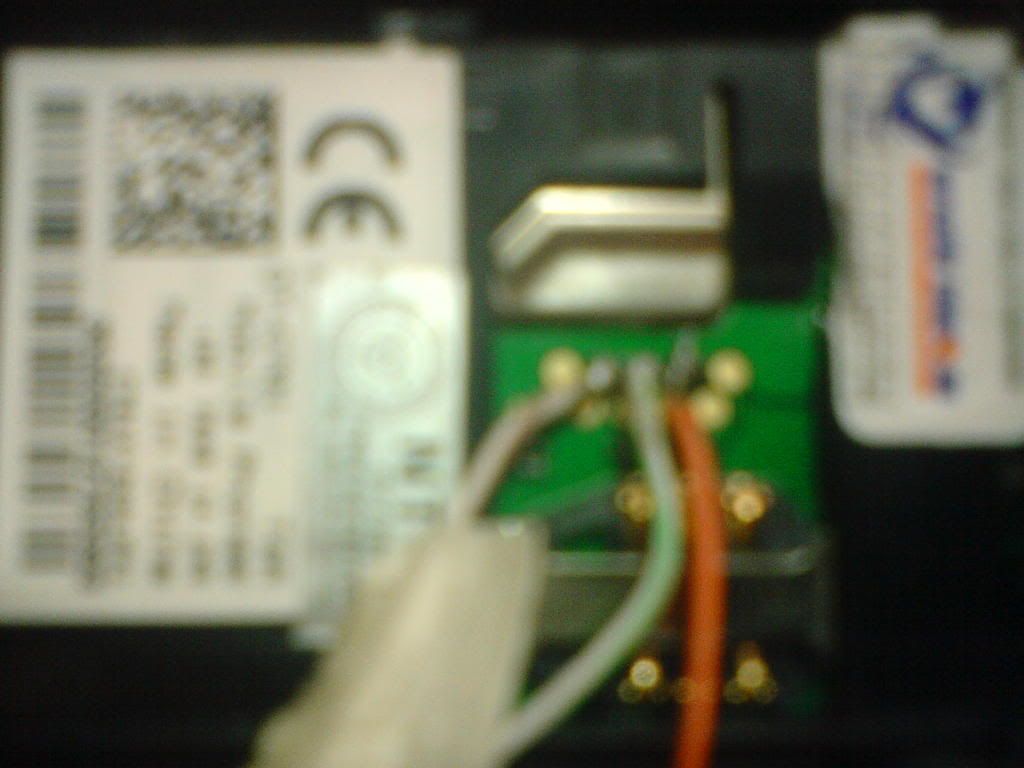

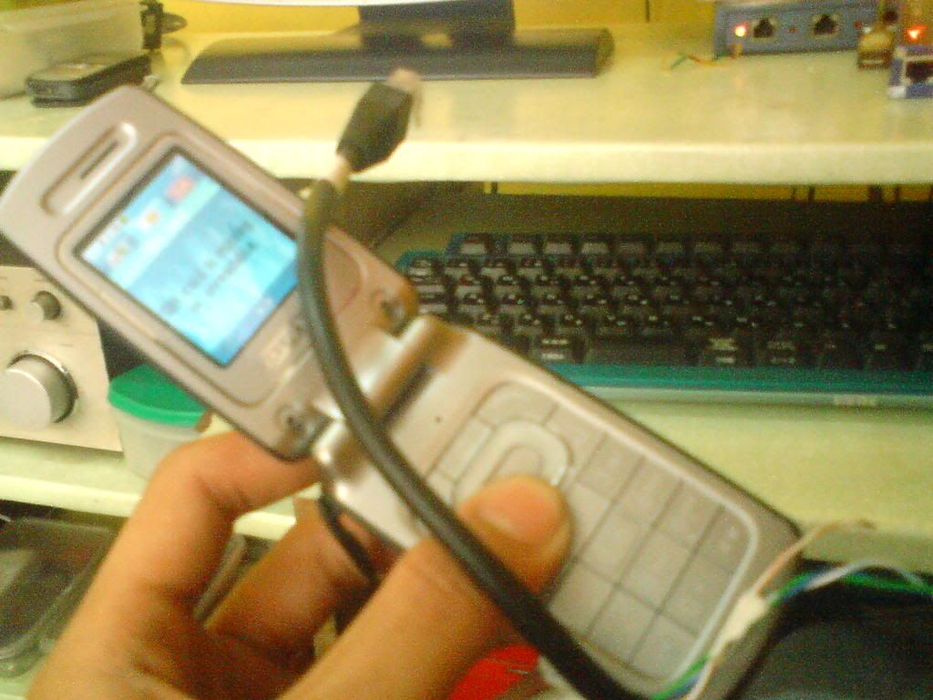

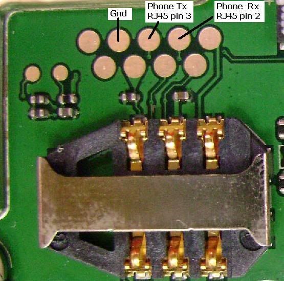

Ito po yon pin out..
